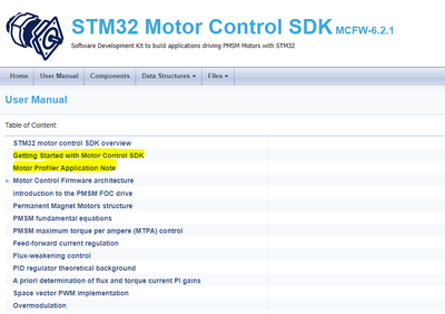

For your info, the firmware does not try to spin the motor. It makes the motor beeping to help you to find your drone in case you lost it for instance ;).
Before going further, could you please read the two highlighted chapters of the documentation:
It will allow you to understand the basics of our solution and how to profile your motor to make it works with our FOC algorithm.
The second document I would advise you to read is the user manual of the board you bought:
If you enable the PWM input control, then, you must apply a PWM signal on the PWM input pin. If you want to give it a try just with the MC Pilot tool, then you can disable the PWM Input control, and control the motor with your PC.
