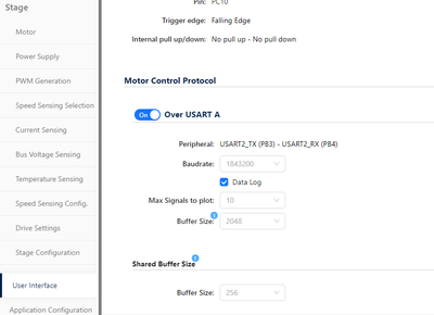

Generating B-G431 with MC-SDK workbench 6.3.2, used Baudrate is available on the "user Interface" tab.
Using the "Discover Board" button on MC Pilot V1.2.12 should work.
