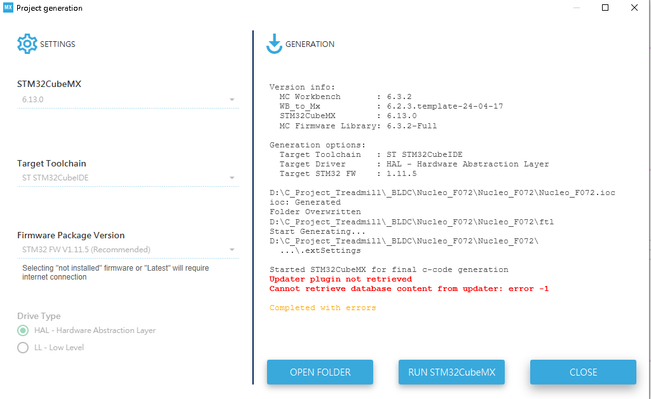

Does STM32Cube_FW_F0_V1.11.5 at least, installed on your CubeMx tool as mentioned on MCSDK6.3.2 Release Note?
2025-03-06 1:04 AM
Hello @walen,
As for your previous post, as generation ends with main.c file, can you proceed with the generated project?
You can update errors_to_skip[] struct (errors will be skipped and no more displayed) and erros_to_war[] struct (errors will be displayed as warnings in orange, preferable solution), in wb2mx.properties file located in "MC_SDK_xxx\Utilities\PC_Software\STMCWB\config".
2025-03-06 2:58 AM - edited 2025-03-06 3:24 AM
1. Can't ,when opening the project in STcube IDE and building it, there are six errors.

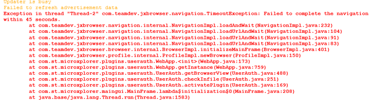

2. Great, thank you. Why does "Updater is busy" happen? SDK 6.3.2 works fine now—what might be causing issues with SDK 5.4.8?

What is stopping it from working?
C:\Users\walen_chang.ALATECHTW\STM32Cube\Repository\STM32Cube_FW_F0_V1.11.5
