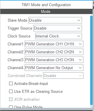

I am using Timer 1 for the generation of 3PWM and their complimentary Signals and I am getting all 6 PWM waveforms.
For six step commutation I need to add phase delay between the channels of the timer. Is it possible using any HAL function? I am not using any motor control library or example code.
Can anyone guide me.

2023-09-13 12:28 AM
Hello @Issamos
I referred to that video but my hardware has been developed and it uses only Timer 1 for PWM generation -> Chanel1,2&3 Please refer the below snap.
Can you please help me in this scenario, I need to start the Timer 1, Channel 2 PWM 120 degree apart

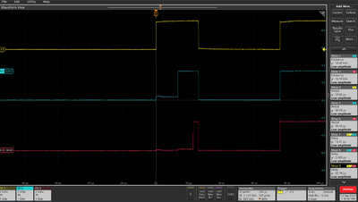

2023-09-13 2:03 AM
Hello @Issamos,
I did the as you said and it worked for only 1st cycle.
Do you want me to attach the Project?
