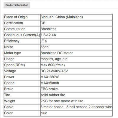

Hello @Issamos
What is "physical abstraction"? Here is some info about the motor.
I set the generator (supply) at 36V, the current at 3A and the RPM max at 200.

Try setting the speed a little higher. on your document it is indicated 600RPM so the motor can go beyond 200RPM

@Zied b. I increased the speed but it didn't change anything
 @Issamos I increased the current to 5A as you suggested and it worked ! I could also increase the speed from 0 to 400 and it also worked. Is that generally the case? Setting the current at the lowest accepted value may impact the  working of a motor ?
