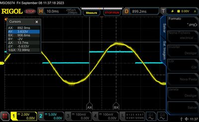

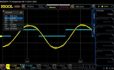

Hi @Gael A thanks for the sugestion.
From the following images I calculated 259° (-101°).
But even changing that, the motor response on turn on was the same

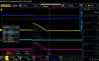

Phase A (Yellow)
Phase B (Light blue)
Phase C (Purple)
Current sensor (dark blue)
Note that the current sensor points 1.9V (450A -> 5V; 0A -> 2.5V; -450A -> 0V). This indicates -108A out of a 5Amax power supply. This event triggers the power supply protection, then reducing the Voltage output, as shown on the phase voltages.
What else could be doing it?

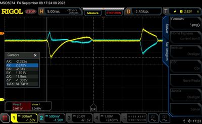

2023-09-08 1:53 PM
Take a look on the Phase U and Phase V currents
Phase U - Blue
Phase V - Yellow
When Phase U is on 67.5A (2.875V), Phase V is on -90A (2V), thus Phase W is on 22.5A.
Does it means that the motor is trying to pull 90A from the power supply?
The weird thing is that I'm trying to slowly feed current to the motor in a low value (0.5A max). But the inverter allways pulls these high currents values when trying to startup. Here's my start-up function
