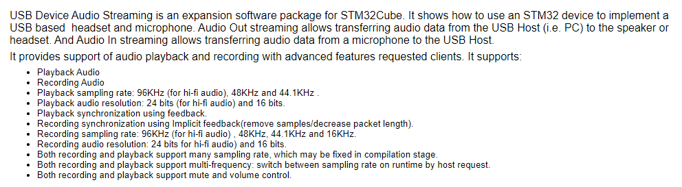

Hi Javier,
The audio rate is 24 bits and 96K Hz.
The X-Cube-Audio release node has the following massage:
The playback support 24 bits and 96KHz, but we don’t know if the full series of MCUs supports.

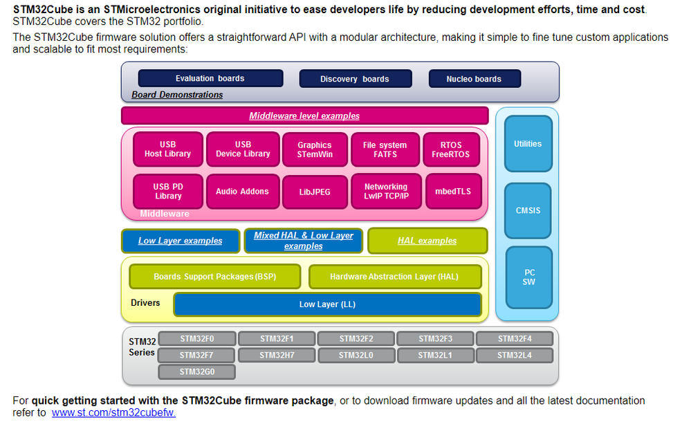

2021-09-30 12:26 AM
im a bit confused, are you mixing software packages?
2021-10-01 1:32 PM
By the way, UM1995 section 4:
CDC libraries are built to run either on a Cortex® M4 or on a Cortex® M7 core, without FPU usage. They can be integrated and run on corresponding STM32F4/STM32L4 or STM32F7 family devices. There is no other hardware dependency.
