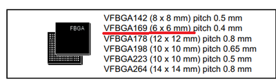

The answer to that kind of question could be found in the datasheet:
6×6 mm package means: VFBGA169 package:
So that depends on the pinout configuration:

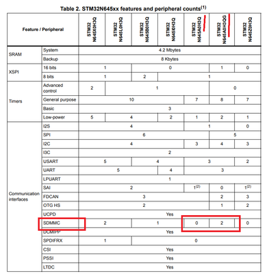

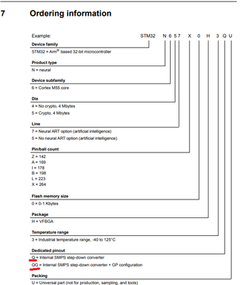

xxxH3Q: no SDMMC interface
xxxH3QG: has two SDMMC interfaces
Please refer to the reference manual for SDMMC details and the Errata Sheet for the limitations of the product.
