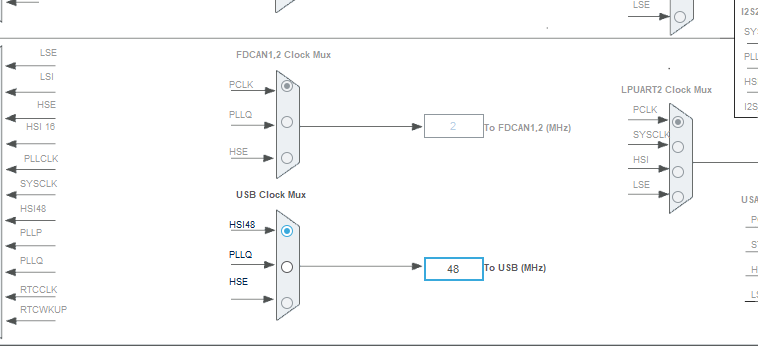

Clock Configurations as like that

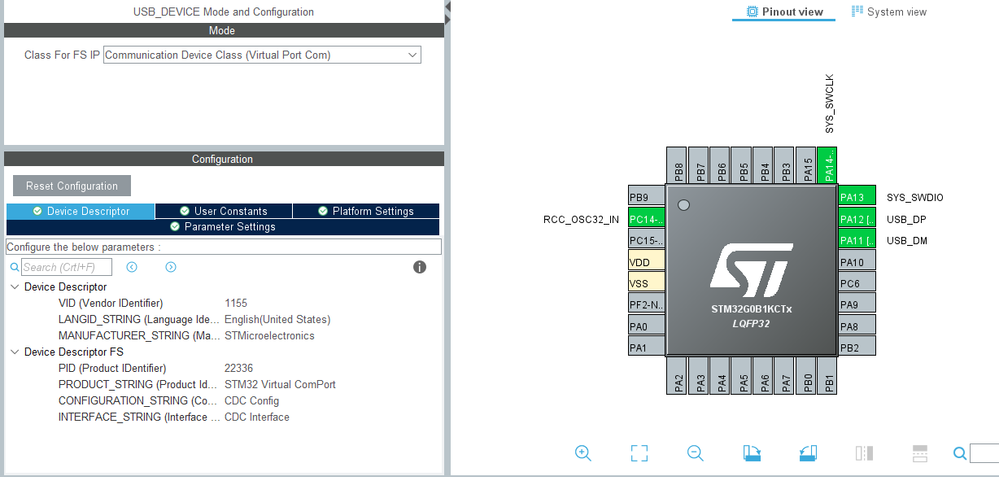

And pin configurations are like that
