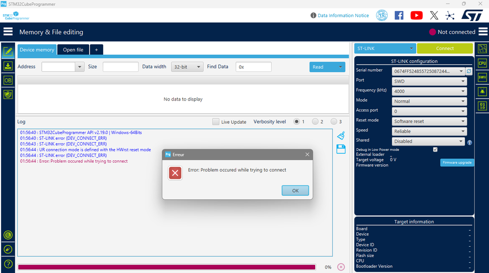

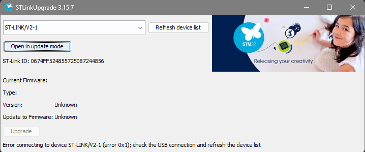

2025-05-27 6:07 PM
When trying to connect to the board using STM32CubeProgrammer, it detects it and recognizes the serial number of the ST-Link V2-1, but it does not establish a connection. The error shown in the first image appears.
And when clicking on Firmware Upgrade then Open in Update Mode, the error shown in the second image appears.

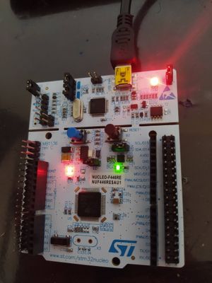

It detects the ST-Link. Good. So firmware likely exists on that chip. Weird that it doesn't display a firmware version.
The target voltage is reported as 0 V. Can't connect to a chip that isn't powered. Is the chip powered? Maybe show a picture of the board with all the jumpers shown.

2025-05-28 5:59 AM
So unplug USB/st-link , then connect it again. (Now is in update mode...)
-> > open in update mode< ...and do the update.
-then try connect to target again.
2025-05-28 7:31 AM
Here is the board with the placement of all the jumpers.

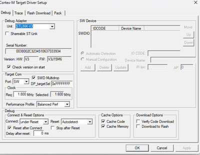

2025-11-05 6:06 AM
Hello guys,
I just got a nucleo-G474. I've tested flashing it and it seems to work.
Then Keil prompted me that there was a firmware update for it.
Updated the firmware and my board is now dead.
The ST link seems to be detected, and I can change its firmware using keil tool, but the G474 uC isn't detected.
Any ideas?
Is this a uC killer firmware? This is my keil screenshot. No target detected anymore.
Any hint on how to solve this?
