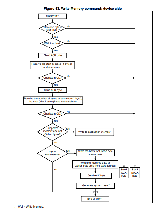

I guess I should have given a bit of background on what I am trying to do instead of just saying UART, thats my bad :grinning_face_with_sweat:. I would like to do the update from another board connected to the STM32 (probably just an arduino to get started after I get it working via terminal). So cubeprogrammer isnt really what I am looking for. However, I am not even using another board yet! Just using RealTerm to send hex commands.
To get me started, I was following AN3155 ( https://www.st.com/resource/en/application_note/cd00264342-usart-protocol-used-in-the-stm32-bootloader-stmicroelectronics.pdf ) to communicate with the bootloader. As you mentioned the basis for my flash is 0x08000000. The size of the binary I am trying to write is 20KB (just trying to flash a blinky program for now). But i just realized the maximum number of bytes to send per the documentation is 256 so i split my binary into multiple .bin files of 239 bytes however trying to write that to flash just results in a bunch of NACK responses. Below is the flow chart I am following. Failure seems to happen at the last "Checksum OK?"

2021-07-30 2:26 PM
That's the right thing to do. Probably your checksum or number of bytes is wrong. Try writing 4 bytes instead until you get it working.

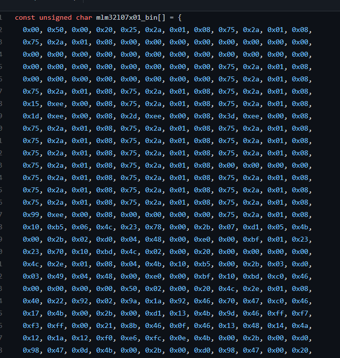

Perhaps look at this as an example, it is used on the ATMEL part on the MKR 1300 LoRa board to reprogram the STM32L072CZ in the Murata LoRa Module. Basically holding BOOT0 HIGH, resetting, and implementing the update process using the aforementioned algorithm.
https://github.com/arduino-libraries/MKRWAN/tree/master/examples/MKRWANFWUpdate_standalone
2021-07-30 10:55 PM
The 4 bytes was successful. So I revisited what I was doing and I get a NACK when i send my checksum value.
The process:
0x31 0xCE
ACK
0x08 0x00 0x00 0x00 0x08
ACK
0xEF (bin data with size of 239 bytes) 0x00 0xEF
NACK
If I am doing the checksum correctly my best guess is that the program I am using (RealTerm) is not sending the .bin how I would expect since my only option is to "Dump file to port"...
2021-07-30 11:18 PM
Thanks that is helpful especially seeing how the FW is stored in a header file:
I think converting my .bin or .hex file to an array of hex values like the one above may help quite a bit. I feel like I'd have some serious problems trying to send an Intel .hex or .bin file from another board through UART. It looks like there is a tool to just do that:
