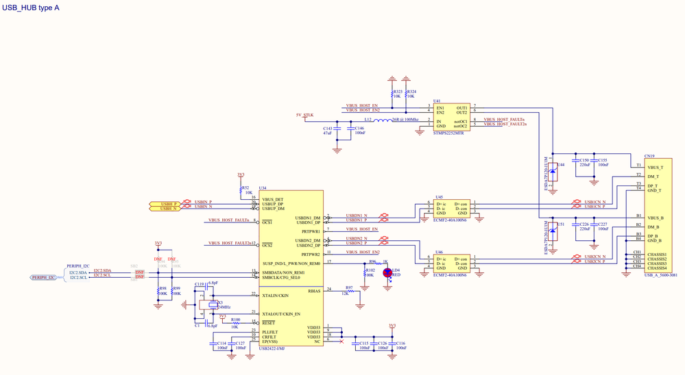

I would like to use the single USB internal PHY on the STM32H735 to connect to a 2 port hub chip (like the Microchip USB2422) so that I can connect to both a USB stick for firmware upgrades as well as a cellular module. I started connecting everything up and then I came across a multiple sources saying that you can't connect USB Hubs to the internal PHY and you have to use the ULPI interface to connect to an external PHY, but none of the sources really explain why other than saying the internal PHY isn't capable of High Speed operation, and the USB software from ST doesn't allow for hubs. I don't understand what this has to do with interfacing with a hub IC when I'm perfectly fine with operating at Full Speed. So I have a few quesitons:
1) Can I use a USB Hub (like the USB2422) as long as I'm OK with it operating at Full Speed only? Is it technically possible to connect these devices and get them to work?
2) Will the USB Host middleware provided through STM32CubeMX work with USB Hub ICs? Do I have to use a 3rd party USB Host Middleware like Keil MDK's?
3) Assuming I can interface the hub chip how does the VBus pin on the STM32 and Hub's Upstream port work? Do I just connect them together and also to the 5V power supply so that both the STM32 and the Hub see that they are connected and getting 5V?

Except this hub is fully internal and you said it doesn't require the power switch. So...coming out of the MCU I have no need for the Enable or Overcurrent Flag signals, the DM and DP signals go into the upstream port on the USB2422 hub and that just leaves VBus both on the MCU and the Hub (the hub has a VBus input). For VBus I was thinking since this is a fully internal hub and there is no power switch both of these pins on the MCU and Hub get connected to the 5V internal power supply.
For the downstream ports there is a duel power switch and the USB2422 handles the enable and overcurrent power switch signals on it's own. There is no need for those to go into the MCU right?

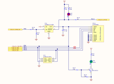

I found something interesting for you: MB1605 ( using STM32MP25)
If you don't need to switch VBUS for compliance or power‑cycling, you can simplify it.

Thank you for the detailed response and sharing the STM32 example with the USB2422. I see the MCU in that design doesn't use VBus Sensing...but it also doesn't seem to have an option for it either.
I have spoken with Microchip support as well and they said in my situation the Vbus upstream input just gets pulled to 3.3V using a 100k resistor. So the only part I'm not 100% confident in is disabling the VBus Sensing on the STM32H735. I've disabled it for the moment because it appears to be part of the OTG protocol (which I'm not using), but if you can explain how it's intended to be used and why I would need it for Host Only applications like this I have no problem re-enabling it and connecting where it should be connected.
