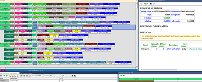

I couldn't reproduce the issue you mention, it doesn't get stuck in USB_WritePacket as you mention. On my end, I used an H7 as device, and here is the trace using 128B for DFU_UPLOAD.

I'm unsure why you sent a DFU_UPLOAD request, I don't even have that implemented in my USB DFU HOST code?
The infinite loop happens when we are sending a DFU_DNLOAD with wLength > 128,
but from your screenshot I see you sent 1 byte. Could you try sending 192 or higher if you're using my code?
Could you provide more information how you are testing this, so I could get a better understanding how I could help?
Are you using the Teledyne LeCroy to send DFU packets or you wrote your own USB DFU HOST example code?
I do not have access to a USB protocol analyzer, so I cannot provide a screenshot.
We only own a SALEAE logic analyzer, but I'm not sure how helpful the output of that would be.
