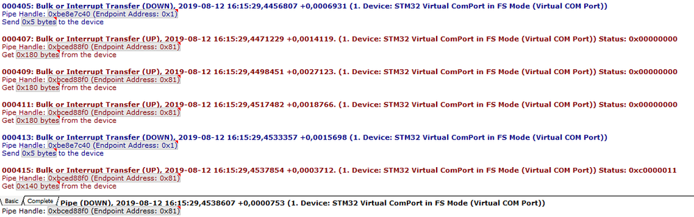

2019-08-12 7:33 AM
It seems that there are 0x40 bytes missing in the last transfer so the host resets the endpoint.
2019-08-12 7:46 AM
Packet count is 1, that means one packet is still not emitted? It would explain 0x40 difference.
