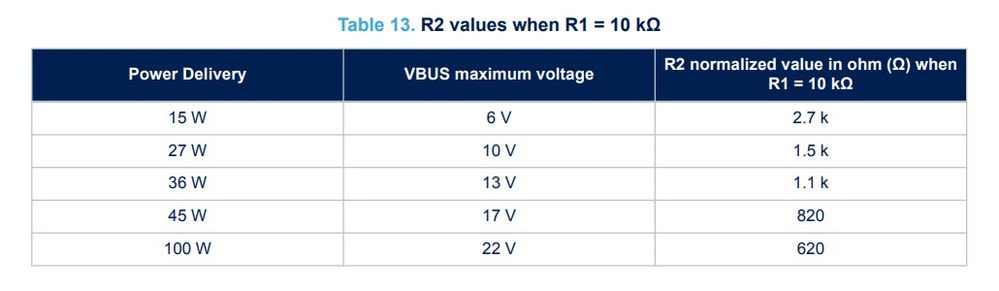

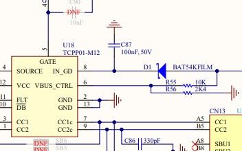

But, on this hardware, the TCPP01 OVP is set to 6V (R56 = 2.4kOhms), then when Vbus=20V it opens the Vbus path.
So you can replace R56 by a 620 Ohms resistor to increase the OVP to 22V.
I have experimentally validated this solution on my end, please let me know.
