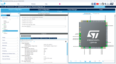

Hello @sin1111yi and welcome to STcommunity!
First, you mentioned STM32H743 in the thread title, but the pinout view shows STM32H750. Can you clarify which STM32H7 device you are using?

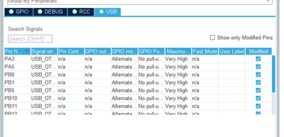

Can you verify that the ULPI pins output speed are configured to very high speed in your .ioc file?

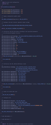

I have already checked my configurations and then corrected device selection, set all USB GPIOs speed to very high speed and set CRS SYNC source to USB HS. But the problem is still existed.
I tried to use USB3320 like STM32H7xxI-Eva before, which have the same problem.

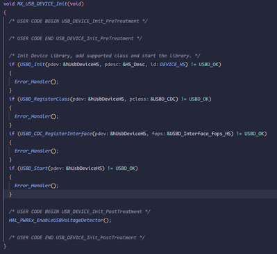

My USB HS related code is all generated by STM32CubeMX and nothing changed, just like the USB HS Device + ULPI examples.
Here's my clock configuration, generated by STM32CubeMX.

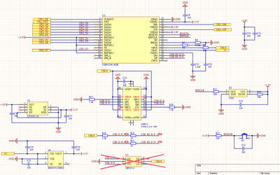

I updated my problem discription, please take a look.
2026-04-09 2:33 AM
All problem are disappeared after I made the ULPI data cable of equal length. Besides, I use PLLQ 60MHz for HS USB.
