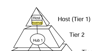

In your system, you have only one host and one device. Between those is the root hub.
In your system, at tier 2, you have a device instead of "Hub 1" but you still have the root hub which is of course a hub and subject to the overcurrent requirements.
