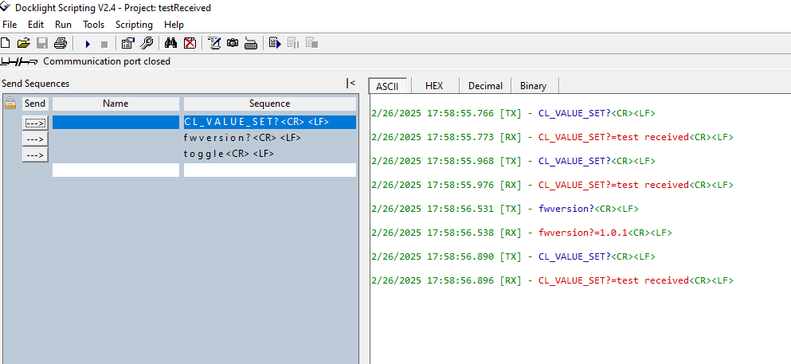

See the attached project which uses a NUCLEO-G071RB, the same family as your STM32. It uses UART DMA (circular mode) with idle detection.
Here is a screenshot of Docklight communicating with the Nucleo
See this github project which explains how the DMA in circular mode with idle detection works and how to save data to a circular buffer and parse the data to a message queue
https://github.com/karlyamashita/Nucleo-G071RB_UART_DMA_Idle_Circular/wiki
