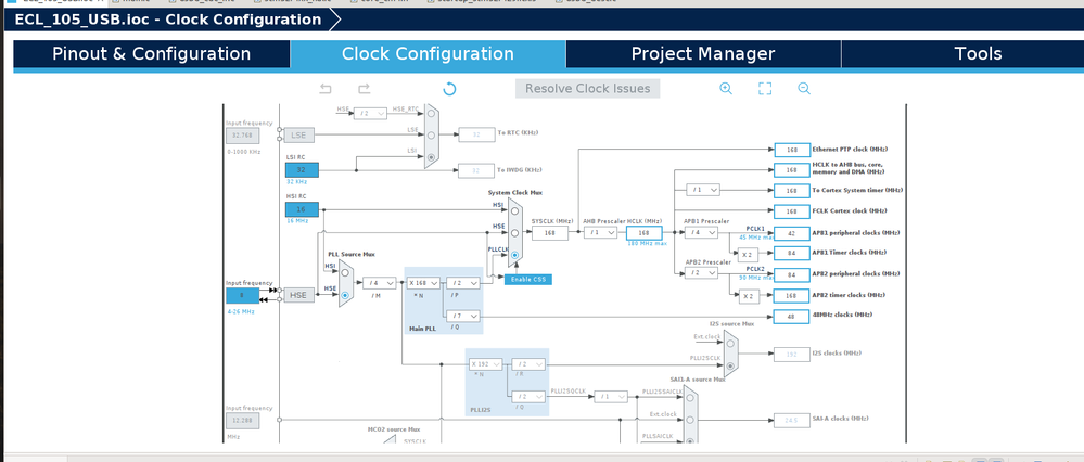

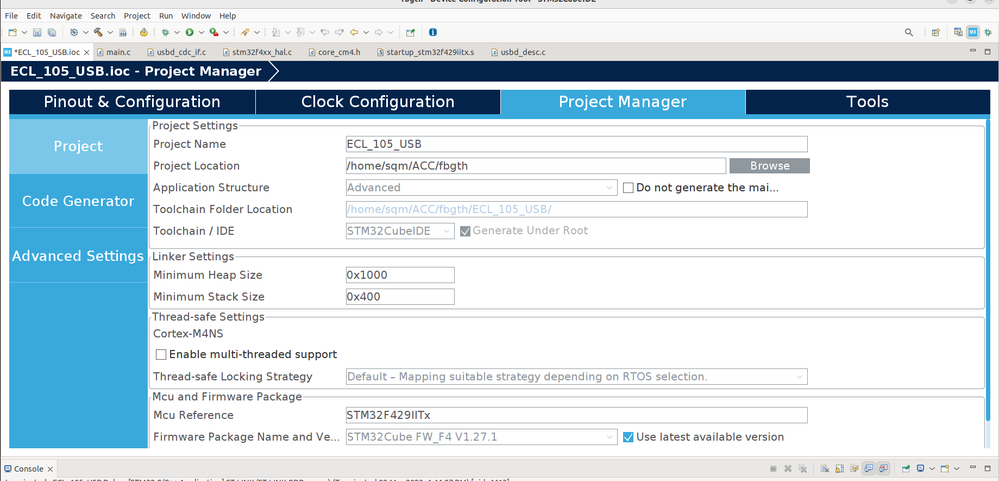

Hey thanks for reply
I have tried it also i increased my heap size to till 0x2000 but still its giving the same error and i also want to ask you that is it happening due to BSP ??
