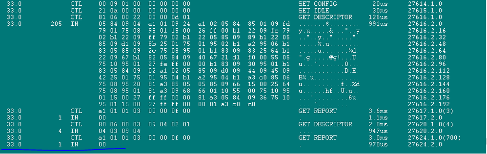

The questions about stm32f1 Usb-hid.The libs from TM32 USB-FS-Device Lib V4.1.0' Custom HID#Insert get report in RESULT CustomHID_Data_Setup/usb_prop.c

If I don't change the original code:
The result of usb communication is this:c00000004 stall pid.I guess because original code not have handle "get report".My request in host by feature.

But the device only responded with a data 0.
0693W00000aHo8XQAS.pngI don`t know why?

JachChen423
Associate II
Now is OK.
uint8_t *CustomHID_GetReport_Feature(uint16_t Length)
if (Length == 0)
  pInformation->Ctrl_Info.Usb_wLength = Size ; //The size is your data length.
  return NULL;
 else
  return (uint8_t *)(&report[0]);
I don't know why.Because I think it had return.But it's ok.!!!???

Thank you for your answer. Unfortunately, I still can't.
JachChen423
Associate II
Now is OK.
if (Length == 0)
  return NULL;
 else
