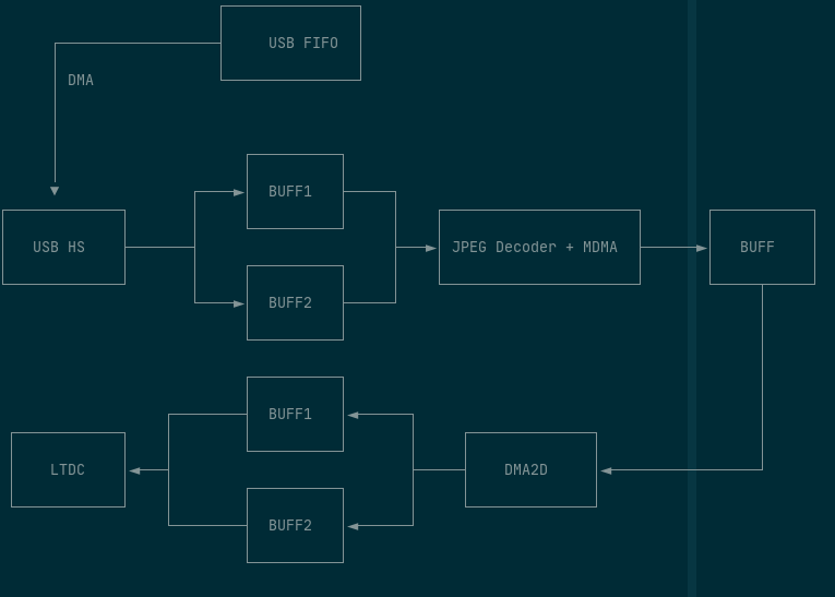

The first one I got from the PC, via USB, JPEG , then I decode it to YUV, then using DMA2D to RGB and then display it using LTDC. Everything works great for one frame.

I was speaking in the context of my program: Disconnecting all non usb funcionality means stopping the processing of data coming from the USB by other hardware components such as JPEG decode, MDMA and DMA2D - (Take a look at the diagram I posted) .
