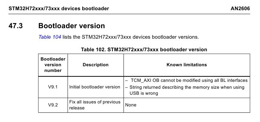

I use STM32H723VET6. Bootloader ver 9.2. When I can send command GO at FDCAN (PD1, PD0), I receive ACK(0x79), but after that MCU is fail.

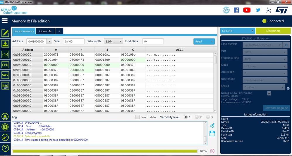

Write memory and Erase memory commands run correct. A program in flash memory mode (BOOT0 pin LOW) run correct. There are no limitations in AN2606:

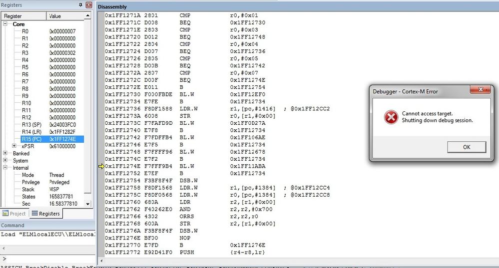

I tried to run the debugger on the STM32H723 (device side). I stop the program, and after the command GO I start it again in step mode. After of several steps disconnection occurs:
Flash in STM32H723:
What am I doing wrong?

2021-10-01 11:36 AM
Above in the line of the disambler:
-> 0x1FF1274E F7FFF9B4 BL.W 0x1FF11ABA
there is a write the address of the next instruction to LR: 0x1FF1ABA, which does not exist.
2021-10-01 12:07 PM
I think you're wrong on the details/interpretation, suggest you save a copy of the Loader ROM, and send/attach that here.
