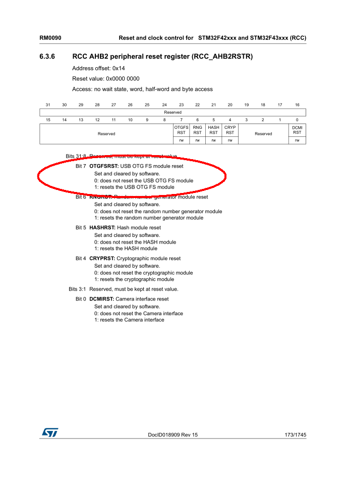

Reset the USB module using the RCC reset register.
2018-06-10 2:07 AM
Nope, did not help either.

2018-06-10 2:14 AM
No, I said reset in reset register (although disabling clocks may be a good idea too, there may be interlocks in RCC preventing changing clock source when they are used).
