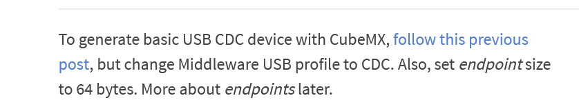

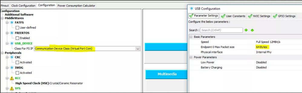

2019-02-25 9:14 AM
Please review the following webpage and test again using the 64 byte recommendation for the EP definition:
https://damogranlabs.com/2018/02/stm32-usb-cdc/
A complete project file is posted on the landing page.
Please post your update after testing.
2019-02-25 10:11 PM
Actually i'm using the same configuration as showed in this site, but it is not working..

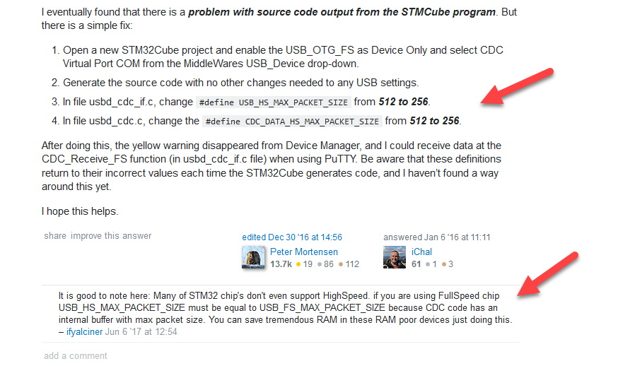

Hi. Please review the following thread,
https://stackoverflow.com/questions/33549084/stm32cubemx-usb-cdc-vcp
and special notes:
Please post your update after this review. If you have done all of these required steps, please post your project / code with details of how you are testing. Include the terminal program being used or whatever to send data to this USB CDC device.

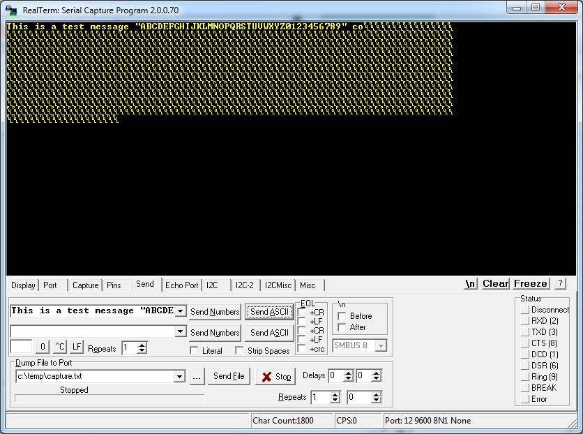

Case 1
After reset i sent "Hello" to Device and it printed some Null characters after Hello.
Case 2
Sent "This is a test message "ABCDEFGHIJKLMNOPQRSTUVWXYZ0123456789" containing more than 64 Bytes" and it printed only 64 bytes with some Null characters after message.

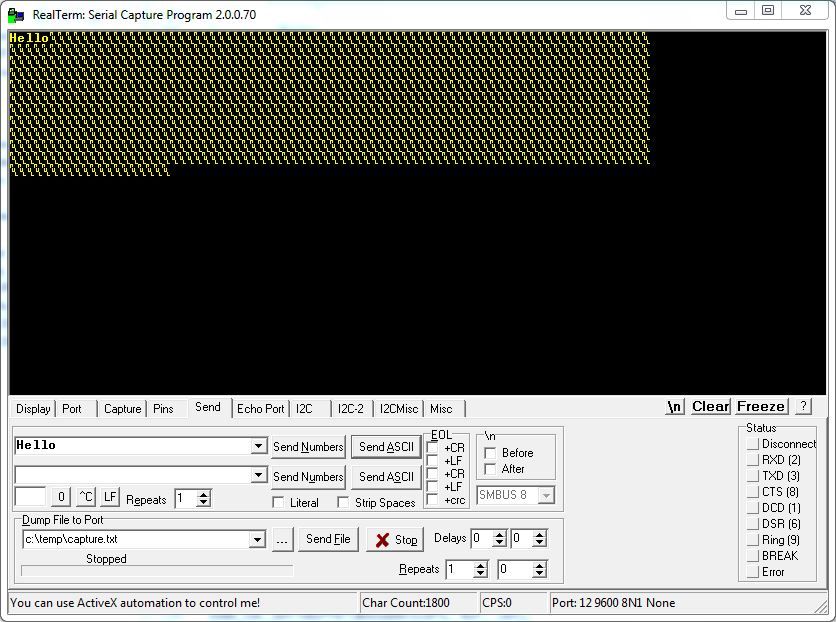

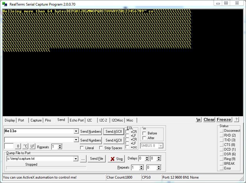

Case 3
Again i sent "Hello" text but this time it printed Hello with part of previous message.
