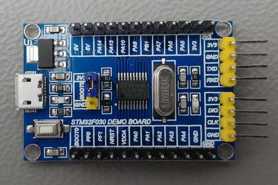

thanks for your reply:
but i used a card of stm32f030f4p6 like this :
2025-09-24 7:09 AM

@boulganamed wrote:but i used a card of stm32f030f4p6 like this
That's not an ST board - please give full details - see: How to write your question to maximize your chances to find a solution
But the fact remains that the STM32 is a 3V microcontroller - so, unless that board contains voltage translators, you will still have to account for that ...

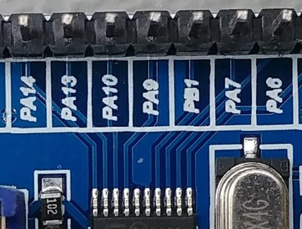

Zooming in, you can see that the header pins connect direct to the chip - there is no voltage translation:
2025-09-24 8:41 AM
I don't see how this changes anything. The microcontroller on that board is not operating at 5 V and can't output 5 V signals.
