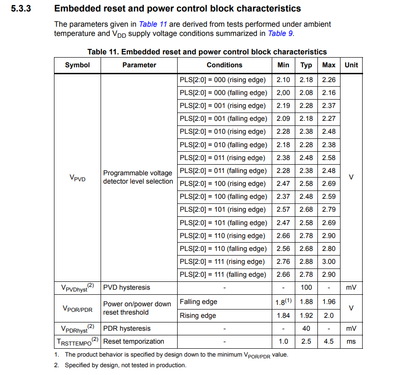

Dear @DMårt ,
Can you please let us know what the absolute VDD/VDDA Voltage desired to trig the PVD Interrupt? and what is the VDD/VDDA voltage of your application with STM32F1 series.
Here are the levels of PVD that we can configure:
Level7 used in the code above - corresponds to 2,66V to 3,0Volts either on Falling or Rising level
Let us know.

2025-09-28 10:52 PM
Hi @STOne-32
On my VDD pins. I have 3.3V.
I want that when VDD pins goes to about 2.9V, then the processor is going to activate the interrupt.
