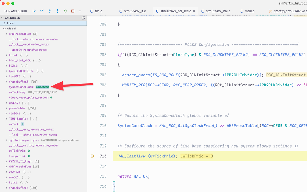

Here is my current 84 MHz clock configuration in CubeMX:
And this is my RCC configuration:
When I flash this code I always end up in a HardFault_Handler before the SystemClock_Config(); function returns.

}When I activate MCO1 I can measure the HSE and PLLCLK signals with the expected frequency.
When I set the SYSCLK to 48 MHz as seen here everything works as expected.
I have no idea what is going on here 🤷�?♂�?

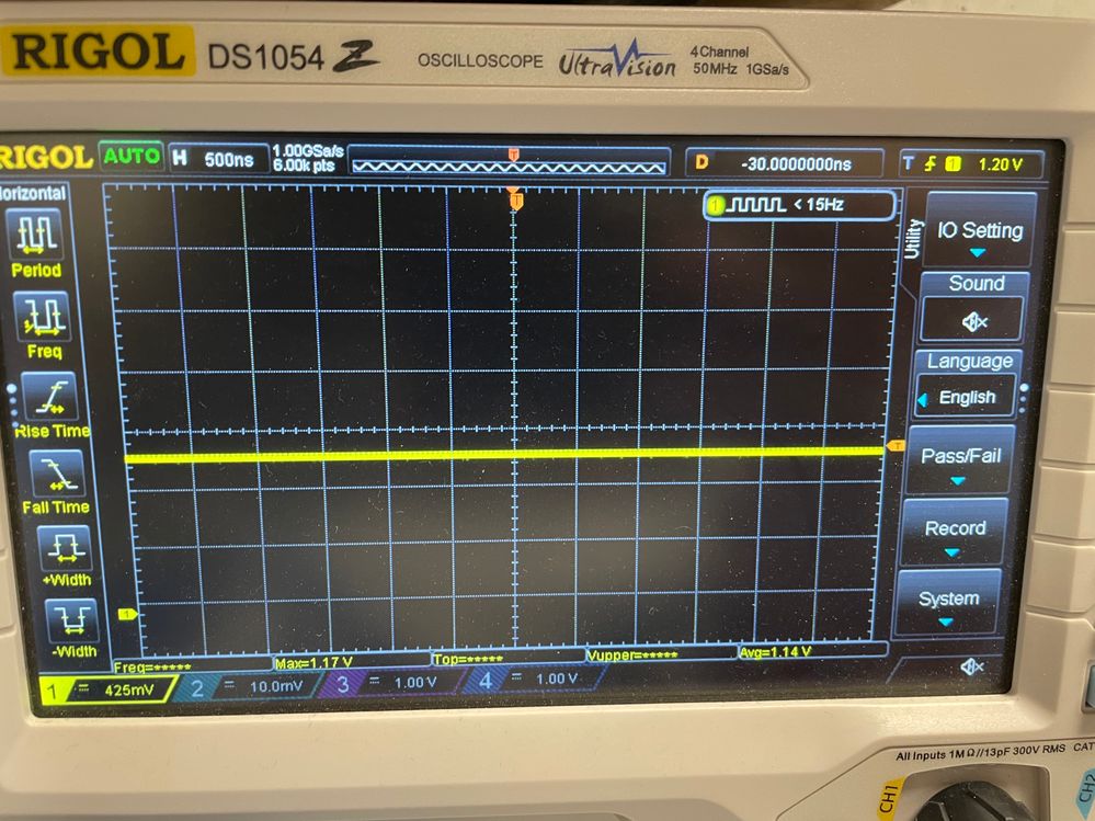

2021-04-07 6:04 AM
Well here's another measurement. Looks a lot better I guess :)
Will test if the MCU boots in about an hour.
But thanks so far!
2021-04-07 6:51 AM
Did you check that at least something is working?
Debug it and ensure that the mcu is actually running.
