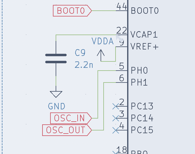

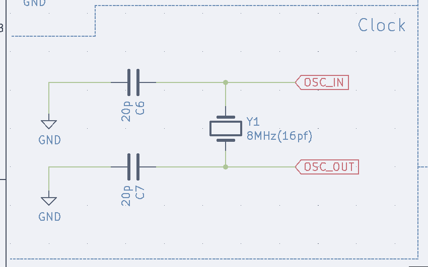

I am having a STM32F401CDU6TR on a custom board and I am not able to run it at 84 MHz SYSCLK. The source is an external 8 MHz crystal with two 22pF caps as seen here:

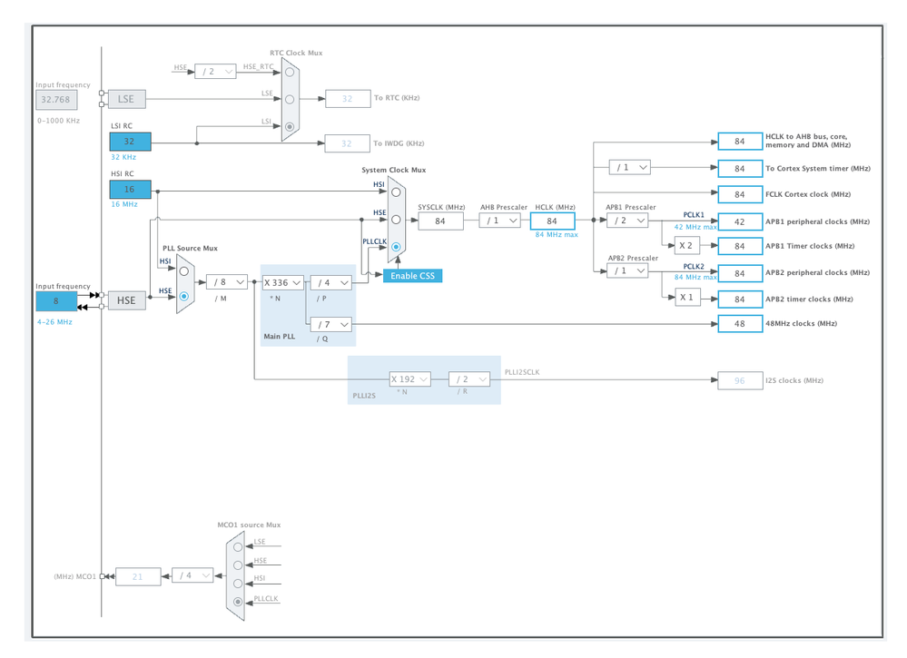

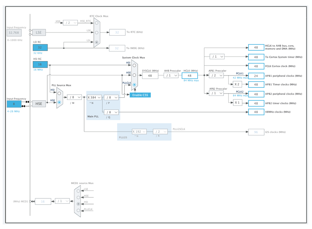

Here is my current 84 MHz clock configuration in CubeMX:

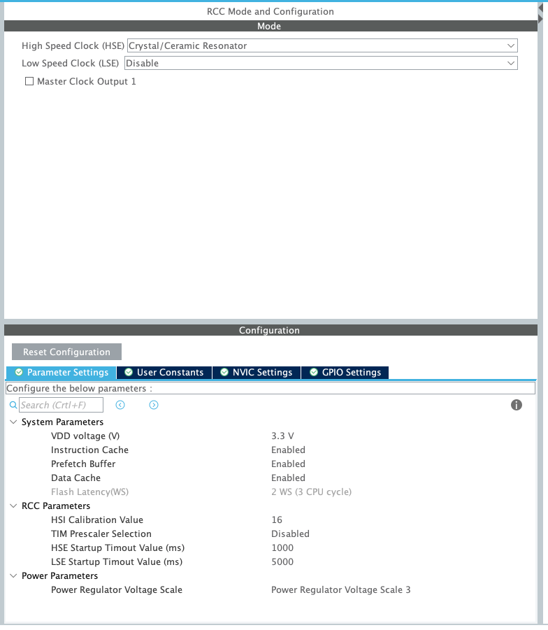

And this is my RCC configuration:

When I set the SYSCLK to 48 MHz as seen here everything works as expected.

2021-04-07 3:43 AM
"8 MHz crystal with two 22pF caps"
It actually shows 20pF
and the crystal is labelled "16pF"
Is it actually oscillating at all? If it is, is it at 8MHz?

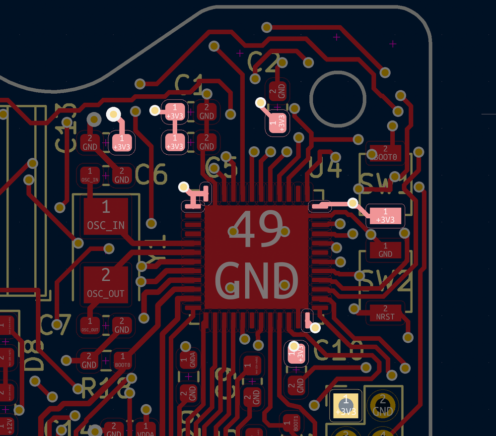

> Do you have adequate decoupling?
I placed 100n decoupling caps across all VDD/GND supply pins around the MCU as close to the MCU as possible.
I might be able to refactor this so the caps are closer. But when I take a look at a nucleo board those seem to be even further away from the MCU.
But I have to admit that my decoupling design could be better. Do you think that is the issue?
Here's a picture of the board layout with the 3v3 net highlighted. Back copper is hidden. Its a 4 layer board.
You're right. I meant to say 20 pF. Thats what I have installed.

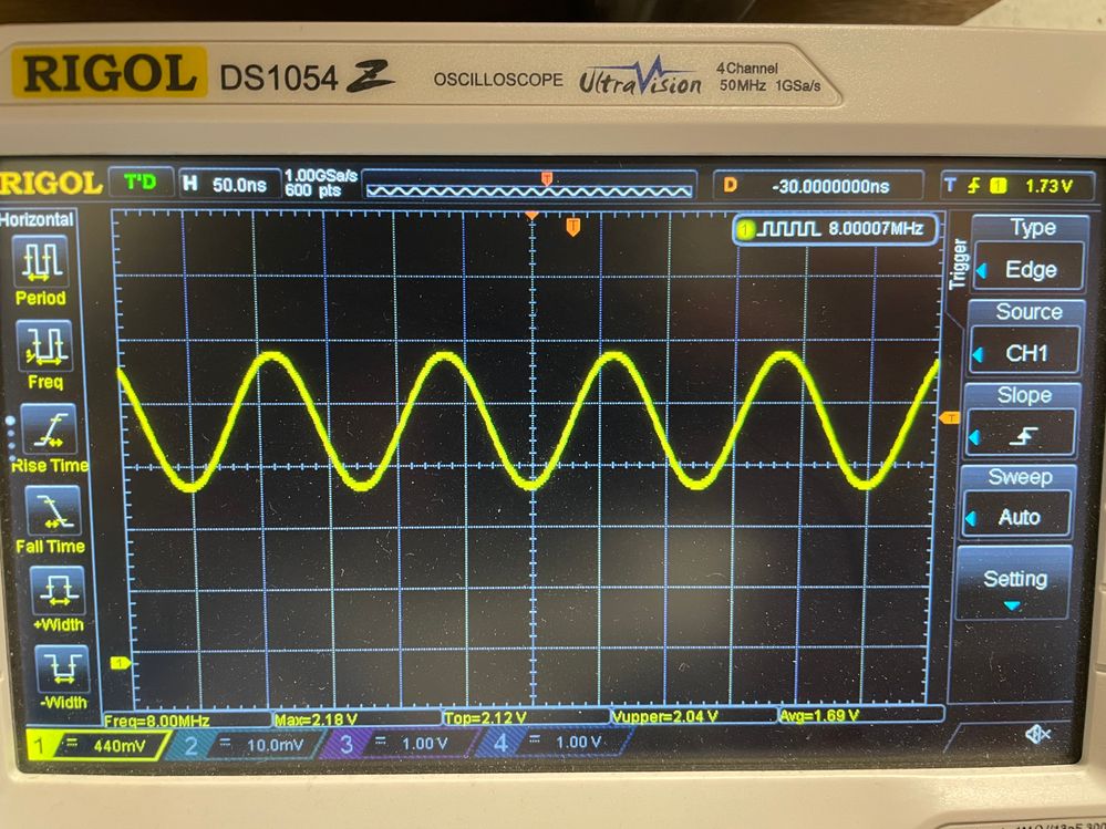

It is oscillating at exactly 8 MHz. The only thing that bothers me is the voltage peak to peak is a little low, right?
Might also be because I am introducing an error when measuring with my 10x probe.
I measured at one of the crystals leads.
2021-04-07 4:42 AM
HSE looks fine

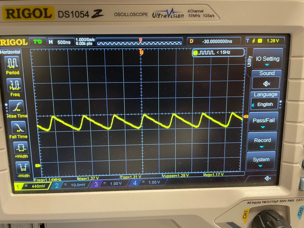

> What's going on with VCAP? Check voltage and capacitor value.
The value is 2.2n as seen here
Thats what I see when measuring on the MCU facing side of the C9. Seems fine, right?

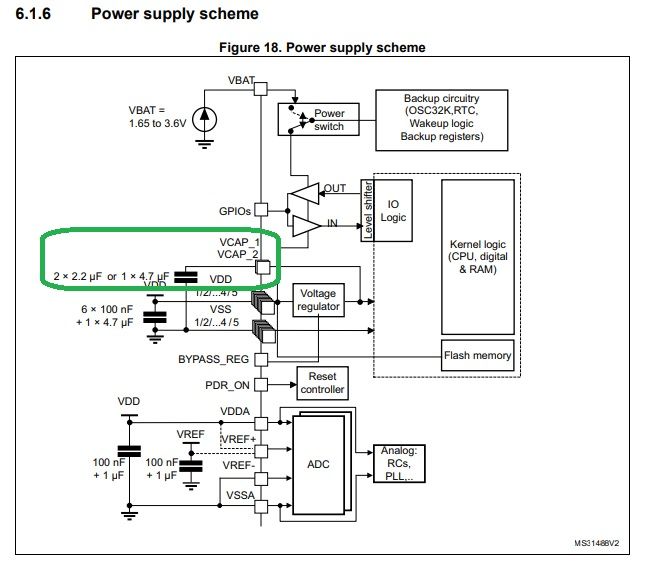

2021-04-07 5:29 AM
Should be at least 2.2 uF, it is a bulk capacitor for the internal LDO
I'll double check the specs, the single up case might be 4.7 uF
2021-04-07 5:36 AM
2021-04-07 5:39 AM
Oh you are right!
Thats clearly a bug.
Thanks for pointing it out. Will swap that for a 4.7uF one.
