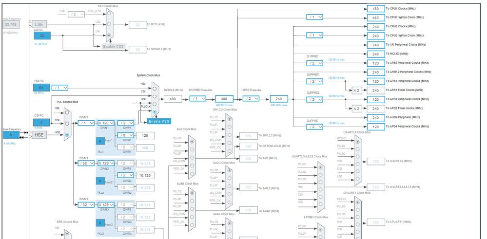

I am trying to establish CAN communication between three different MCUs: NUCLEO-H723ZG, NUCLEO-H755ZIQ, and NUCLEO-G474RE. However, I am unable to successfully communicate between the boards, even though the same baud rate has been configured on all MCUs. I have also connected an external CAN transceiver to each board for proper CAN bus operation.
On the NUCLEO-G474RE, I have enabled UART4 to send command data, using the following pins:
PC11 – UART4_RX
PC10 – UART4_TX

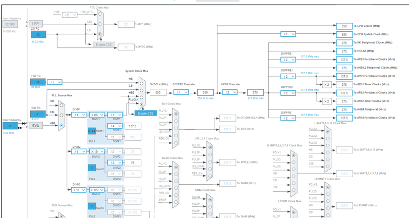

Clock Frequency [SYSCLK] & Baud Rate [CAN]:
1. NUCLEO-H723ZG: 550 MHz
Baud Rate: 500000 Bit/s
2. NUCLEO-H755ZIQ: 480 MHz
3. NUCLEO-G474RE: 170 MHz

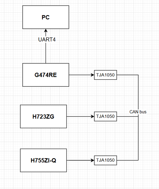

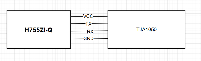

2- Please describe what you've did at this stage to debug the issue and show your CAN bus diagram in this way:
3- What transceiver are you using? and show your hardware schematic.

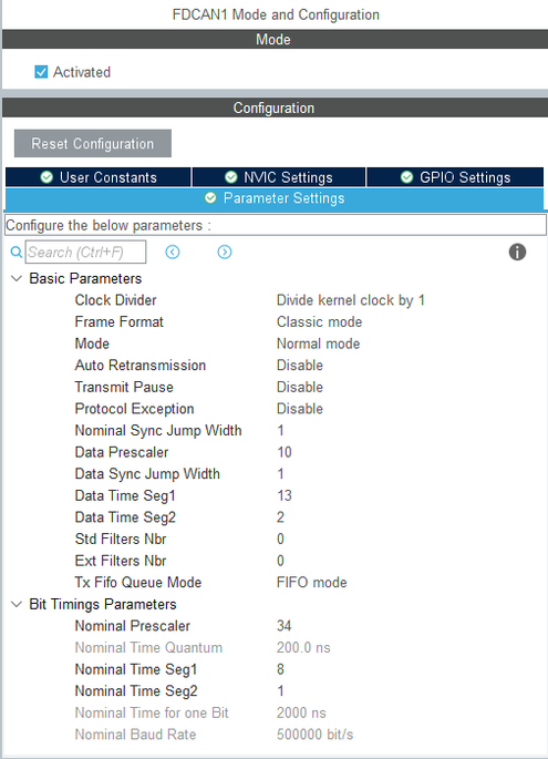

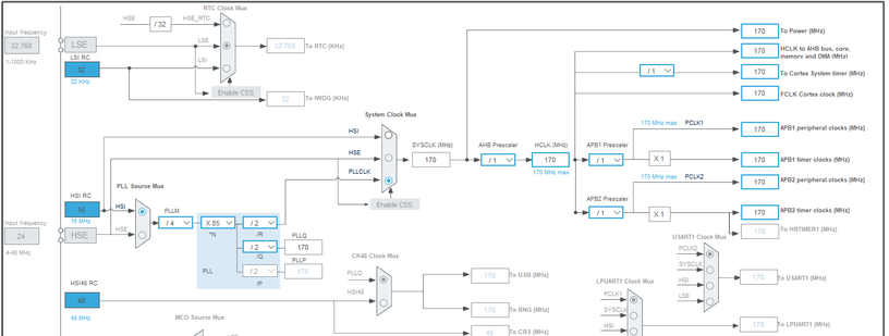

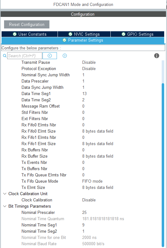

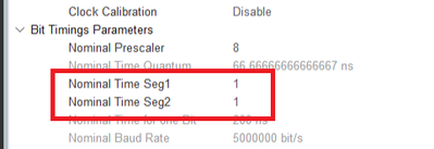

PS1: avoid using HSI for CAN and use external precise clock source such as a crystal. Here you are using HSI for G4 project! and avoid setting 1tq for one of the time bit segments:
PS2: please attach the ioc files instead of sharing screenshots of your CubeMx config
2026-02-10 5:12 AM - edited 2026-02-10 5:18 AM
I am using UART4 on the NUCLEO-G474RE to send command inputs along with the target address for toggling GPIO pins.
All three MCUs are connected through a CAN bus network. When a command is sent via UART4, the G474RE acts as the CAN master and transmits the corresponding CAN message to the other MCUs to control their GPIO outputs.
Each board is interfaced with a TJA1050 CAN transceiver for proper CAN communication.
Example use case:
If I send a command from the G474RE board to toggle a specific GPIO on the NUCLEO-H723ZG, the targeted GPIO pin should turn ON or OFF accordingly.
VCC is connected to the 5V
GND is connected to the GND pin of the board
NUCLEO-G474RE (0x100) - Led Pin no: PA5 (acts as Master)
PA12 - FDCAN1_TX
PA11 - FDCAN1_RX
PC11 - UART4_RX
PC10 - UART4_TX
NUCLEO-H723ZG (0x101) - Led Pin no: PB0
PA12 - FDCAN1_TX
PA11 - FDCAN1_RX
NUCLEO-H755ZIQ (0x102) - Led Pin no: PB0
PD1 - FDCAN1_TX
PD0 - FDCAN1_RX

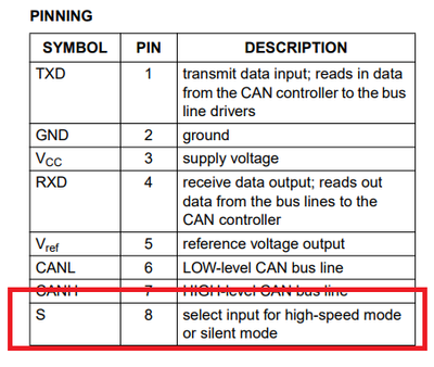

PS4: what about S pin level of the trancveiver?

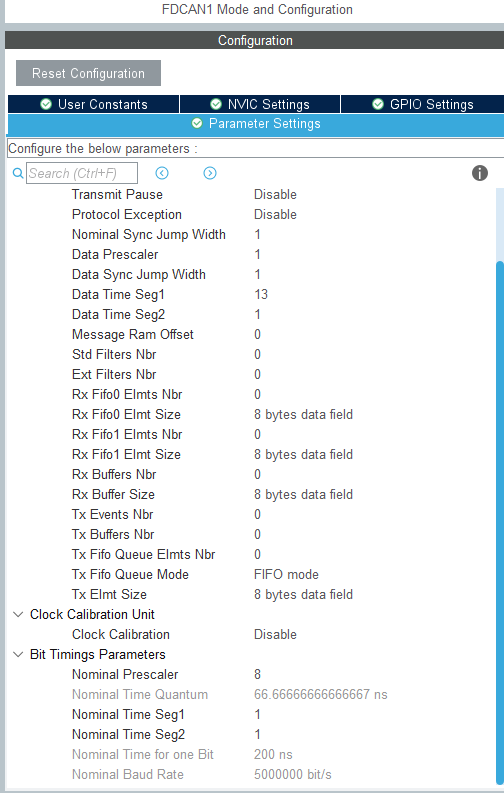

I've just noticed this configuration:
That's a bad configuration.TSEG1 =TSEG2 = Tq!
You need to avoid such timing configuration and you need to position the sample point at about 87.5%. Decrease the the nominal prescaler and increase TSEG1 and TSEG2 values as much as possible with the proposed sample point.
Read this article: CAN (bxCAN) bit time configuration on STM32 MCUs . It treats bxCAN but applies also to FDCAN in Classic mode.
