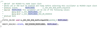

Here's the bit you need to set:
Doesn't seem to be a way to do that in CubeMX. Not everything is clickable. Might need to add this yourself.
Edit:
Here's an example which uses LSE as the input/sync. Modify that to use HSE instead:
