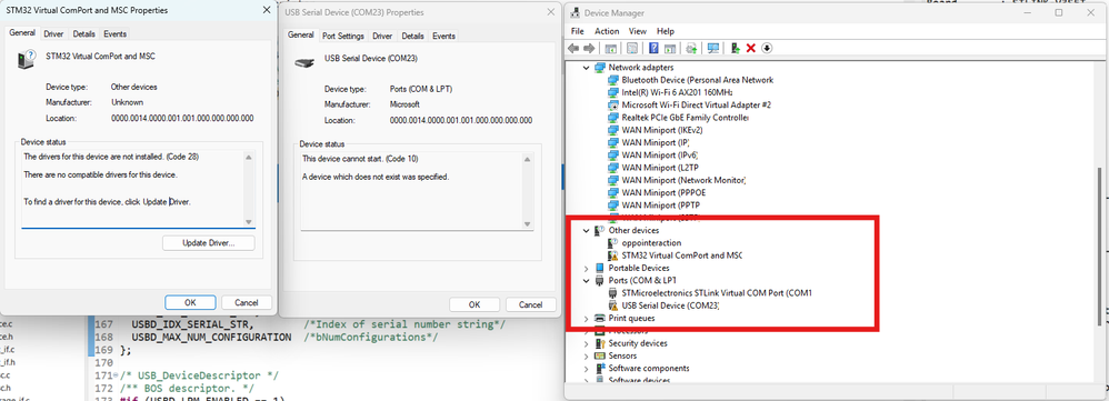

Here i have updated
0xEF, /*bDeviceClass*/
0x02, /*bDeviceSubClass*/
0x01, /*bDeviceProtocol*/
After running the firmware i can see msc device on pc. But in case of cdc, its showing code 28 and code 10. I have attached the image,
Also i am updating the latest files with this post.
I believe i am missing something.
Any help will be appreciated.
