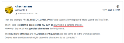

I ran the example project and successfully displayed “Hello World” on Tera Term.
Then I tried to port this project into my own one.
However, the result was garbled characters in the terminal.
The baud rate (115200) and PLL/clock configuration are the same as in the working example.
Do you have any idea what might cause the characters to be corrupted?

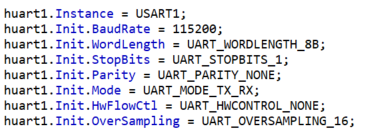

static void MX_USART1_UART_Init(void)
huart1.Instance = USART1;
huart1.Init.BaudRate = 115200;
huart1.Init.WordLength = UART_WORDLENGTH_8B;
huart1.Init.StopBits = UART_STOPBITS_1;
huart1.Init.Parity = UART_PARITY_NONE;
huart1.Init.Mode = UART_MODE_TX_RX;
huart1.Init.HwFlowCtl = UART_HWCONTROL_NONE;
huart1.Init.OverSampling = UART_OVERSAMPLING_16;
if (HAL_UART_Init(&huart1) != HAL_OK)
Error_Handler();

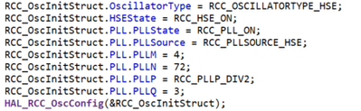

/* Enable HSE Oscillator and activate PLL with HSE as source */
RCC_OscInitStruct.PLL.PLLM = 4;
RCC_OscInitStruct.PLL.PLLN = 72;
RCC_OscInitStruct.PLL.PLLP = RCC_PLLP_DIV2;
RCC_OscInitStruct.PLL.PLLQ = 3;
HAL_RCC_OscConfig(&RCC_OscInitStruct);

Fig.1 Display result
Fig.2 PLL configuration
Fig.3 Baud rate (115200) on Teraterm
Fig.4 Baundrate on project

You forgot to link to your previous thread: Unable to display messages on Tera Term via USART1 on STM32F429I-Discovery
The fact that you are now seeing anything on your TeraTerm shows that you do now have connectivity from your STM32 all the way through to TeraTerm.
Getting garbled characters (almost) certainly means that the baud rate is wrong.
So check your assumptions carefully: eg, is your clock frequency really what you think it is ?
Use an oscilloscope to see what baud rate is actually happening on the wires.

2025-11-10 2:13 AM
You've omitted this information:
How did you port the USART example to your Camera project?
2025-11-10 4:01 AM
@chachamaru I see you've marked a solution - good to hear that it's fixed.
Again, it would be helpful to say what, exactly, was wrong in your project - this would help future readers who may find this because they are having the same problem ...
