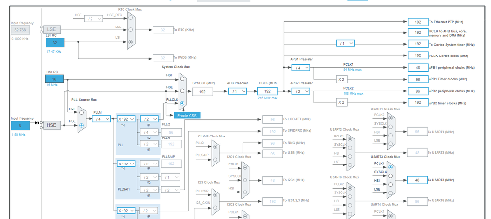

Clock tree from MX

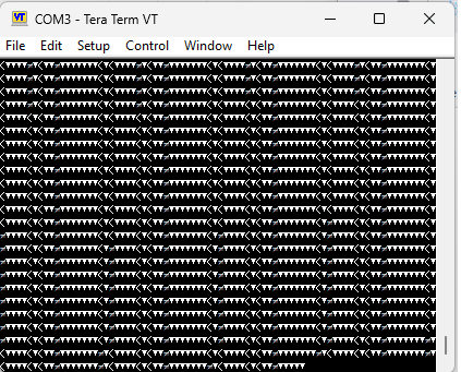

Output in Tera Term window

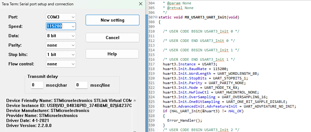

TT is set up exactly the same as the UART init in the code.
Anyone know whats going on here?

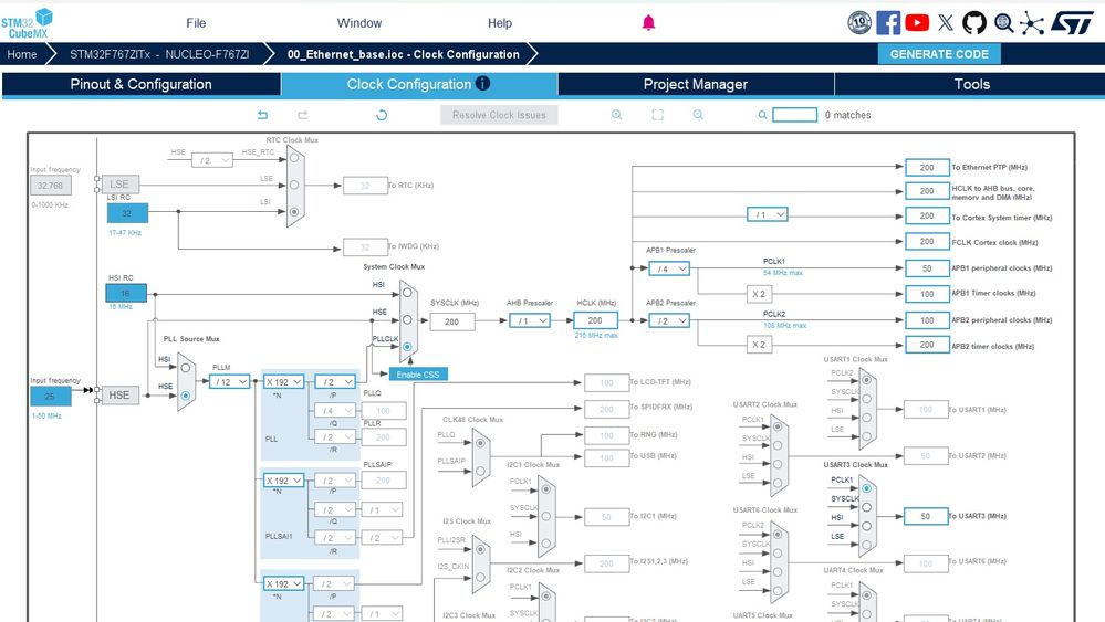

You have set a wrong HSE clock value to 25MHz:
You need to set it to 8MHz as the ST-LINK-V2 MCO output on that Nucleo board is 8MHz
2026-03-25 10:59 AM
Gibberish on a terminal is almost always due to wrong baud rate.
As @mƎALLEm said, if you enter the wrong value for the HSE clock frequency, then your baud rate will be wrong - as will any other frequencies derived from HSE.

Still gibberish

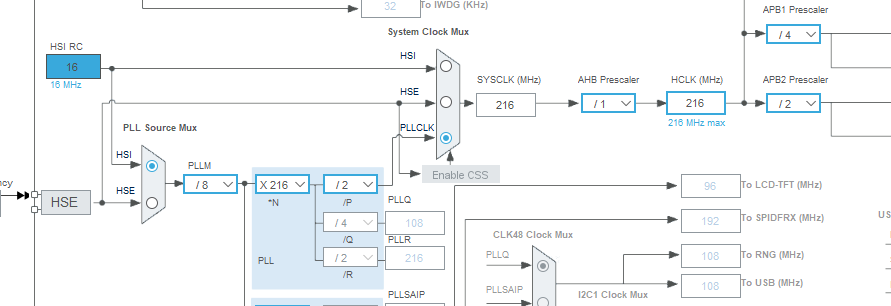

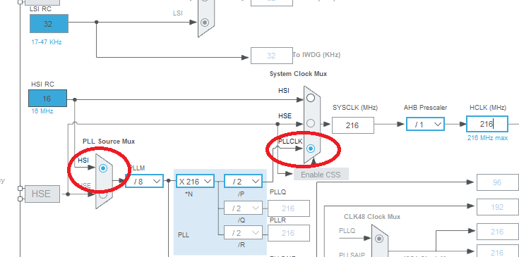

And what if you select HSI as clock source instead of HSE?:
If it's working, that means definetly you have an issue with HSE, a missing solder bridge on STLINK MCO output path or something similar. If not, you have an issue with TeraTerm UART configuration.
2026-03-25 11:59 AM
No not working with HSI either
Settings in TT are the same as in the USART3 init. (I've also tried RealTerm & get the same gibberish there too)
