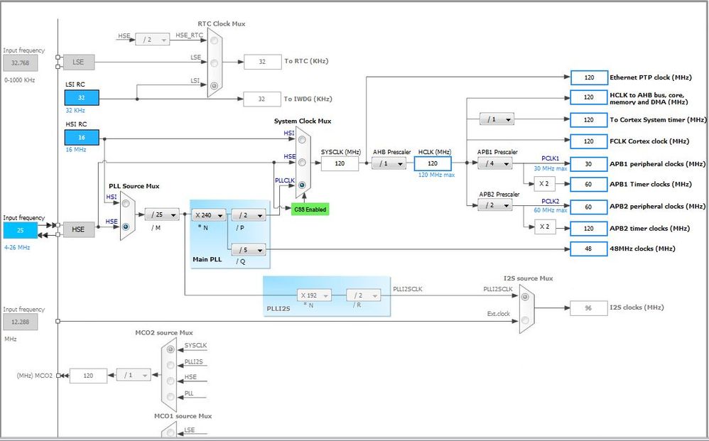

I am using STM32f429-Disco. USB library was working, how data was corrupted. Then I corrected lines belowstatic void SystemClock_Config(void){
RCC_OscInitStruct.PLL.PLLM = 8;
RCC_OscInitStruct.PLL.PLLN = 336;
RCC_OscInitStruct.PLL.PLLP = RCC_PLLP_DIV2;
RCC_OscInitStruct.PLL.PLLQ = 7;
} PLL_VCO = (HSE_VALUE / PLLM) * PLLN = (8000000/8)*336 =336000000 USB OTG clock = PLL_VCO /PLLQ = 336000000/7= 48000000 (48MHz) As per datasheet , for internal USB PHY clock should be 48HMz, and for external PHY it should be 60MHz. Regards, Provat
