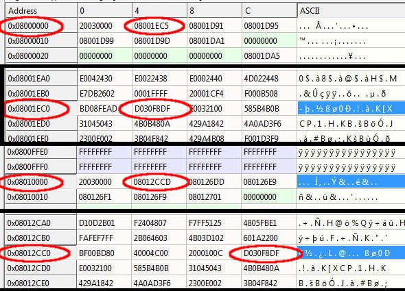

Hello, I'm trying to run this bootloader on a custom board with a 429IG on it. My target application runs fine, but I need to be able to update on site through usb.
So far, the bootloader writes the image on the chip, but it seems it doesn't jump to the application address. Here are my settings: Bootloader side:#define APPLICATION_ADDRESS (uint32_t)0x08010000

Here's the interesting part of the memory view from the ST-LINK Utility after flashing the BL, and writing the target app from the usb key (the chip was fully erased prior to the procedure).

2015-08-09 12:24 AM
Thanks Clive, that did it!
