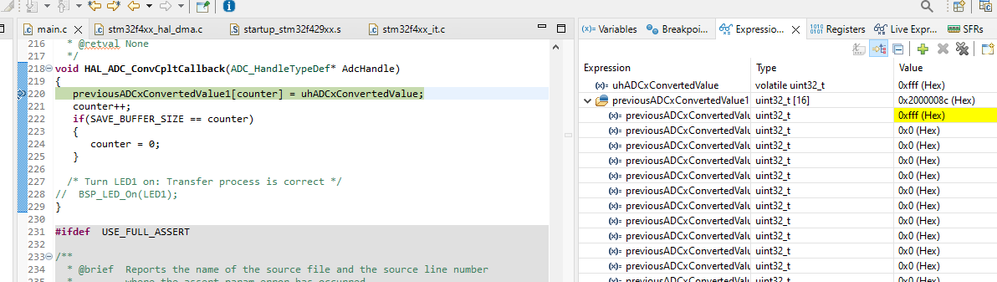

I will be surely discarded for what I did, but: I added a breakpoint on BSP_LED_On() to check that each time a conversion + DMA transfer is done, value is saved.
But it does not...

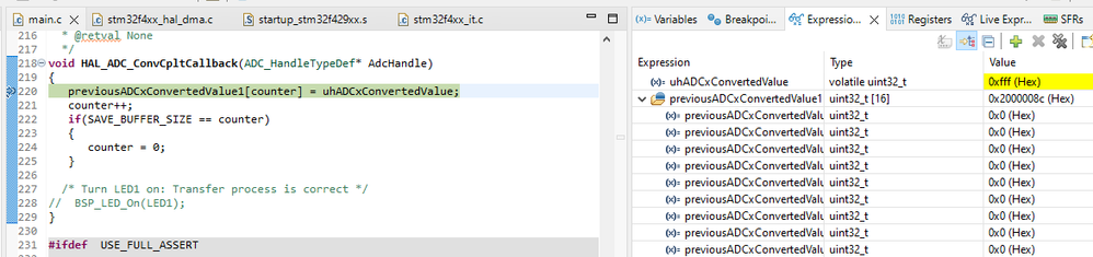

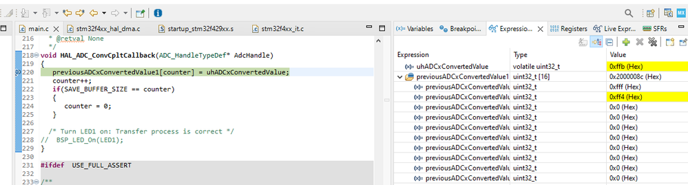

There values are totally different... maybe like there are a couple of other ADC conversion + DMA transfer which do not trigger this callback. I made 5 iteration (5 times resumed program after breakpoint hit) and got the following evolution of my array:
Here, we may confirm that values in array do look like value coming out from the ADC (it is linked to +3V3 with a 10k resistor) BUT they are not equal to value transferred with DMA.
