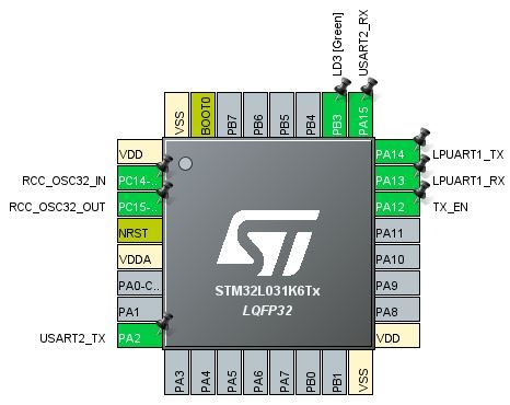

The development board I use: NUCLEO-L031K6
The UART of interest:USART2

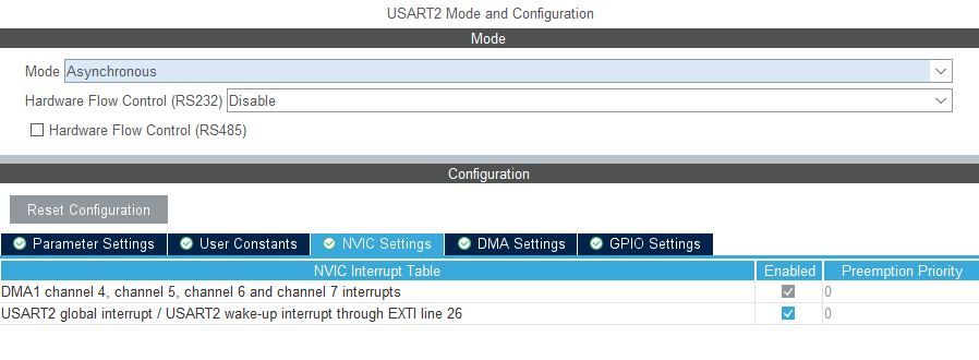

As you can see in my setup, the USART2 global interrupt ist set.
Could somebody point me in the right direction to look for the problem?

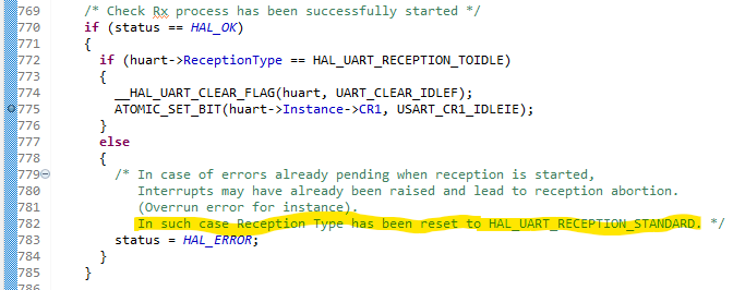

2023-03-31 12:16 AM
That's right i forgot that you get the 16 bytes.
I'd check the HAL status when you call HAL_UARTEx_ReceiveToIdle_DMA. More than likely it returns as HAL_ERROR. So based from the notes i highlighted it reverted to HAL_UART_RECEPTION_STANDARD. That would be the only explanation why you're not getting interrupts on idle.
Check the HALdriver stm32l0xx_hal_uart_ex.c and put a breakpoint on line 775 and see during debug if it breaks.

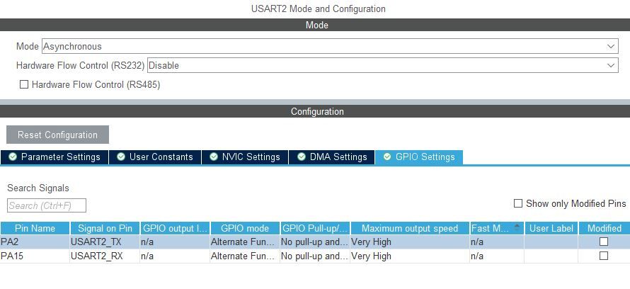

2023-03-30 11:46 PM

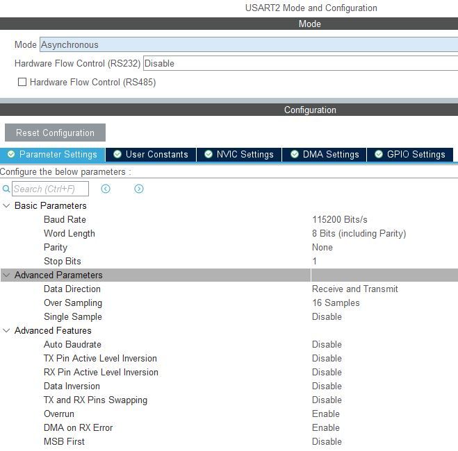

I assume you're using the VCP? Did you check with an oscilloscope to see if the PC is sending data and you see data activity on PA15? Baud rates match?

2023-03-31 12:16 AM

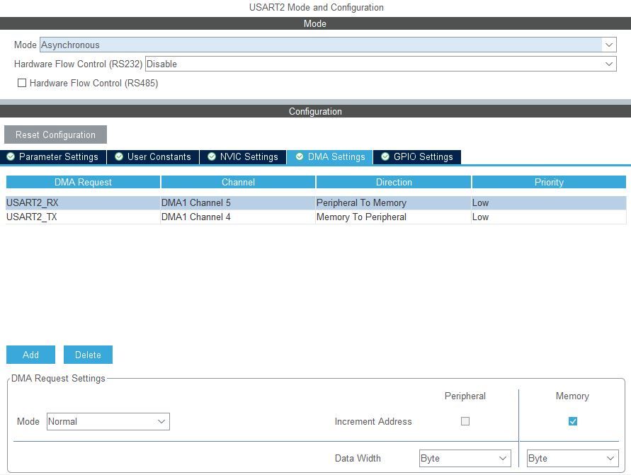

If the DMA (half)complete callbacks are working, but the IDLE does not, it means the UART interrupt for some reason doesn't work. Stop clicking and check the actual CubeMX generated bloatware.

Hi Karl,
it was not exactly the reason but the right direction. In fact I missed to check the
Status of the HAL between two conscutive called DMA functions.
