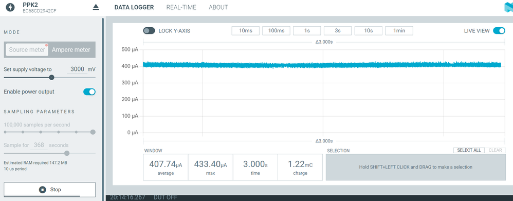

I am measuring the current consumption by using the Power Profiler Kit by Nordic. I have simply connected the Vout and Gnd of the Kit to 3.3V and Gnd of the board respectively. The current consumption in source meter mode is shown below.
I have also tried making changes into the code such as re-initialising the LED pin to Analog and disabling the clocks before entering STOP2 Mode, but have seen no changes in the current consumed.

Using the Ampere Mode of the Power Profiler Kit and supplying voltage to the STM board through USB has helped me reduce the STOP MODE current. But now the MCU seems to immediately wake up after entering stop mode.
I have disabled every interrupt except the RTC, as well as suspended Systick before entering sleep, but the problem still remains.
