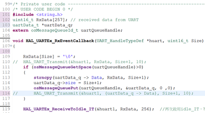

1. For the project using freeRTOS, I've successfully completed sending messages to the MCU in Serial Motior (using Idle Interrupt).
2. when I call HAL_UARTEx_RxEventCallback(), I can use HAL_UART_Transmit() to send back UART data (line 110).
(main.c)
(main.h)
BUT when I run strncpy and update struct (line 114, 115), I can't receive the response (line 116)
If I only run osMessageQueuePut(), I can receive the RxData content.
It looks like I can't access the struct content.
I am confused about this situation.

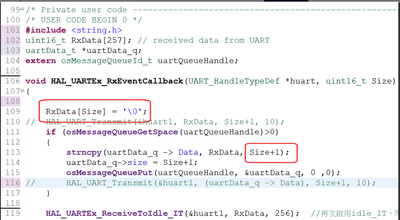

@jessie_chiu wrote:when I run strncpy and update struct (line 114, 115), I can't receive the response (line 116)
You define a buffer of length Size, but you tell strncpy() to copy a length of Size+1:
Correction:
The buffer length is 257, but you are still copying more data than has actually been received
Also, uartData_q is just a pointer - have you actually created any storage for it to point to ?

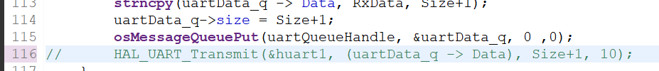

In lines 114 and 116 of the screenshot is where I have called the uartData_q storage.

@jessie_chiu wrote:In lines 114 and 116 of the screenshot is where I have called the uartData_q storage.
You don't "call" a data structure?
Actually, line 116 is commented-out - so it does nothing.
In line 114, you dereference the pointer:
That is, you try to access the memory that the pointer is pointing to.
But you haven't shown where that pointer gets set to point to any actual memory.
That was my question.
If the pointer uartData_q hasn't been set to point to any actual memory, then line 114 is, at best, going to be a NULL pointer reference ...
Somewhere, you need to create an actual uartData_t structure, and then you need to set the uartData_q pointer to point to it; eg,
uartData_t uartData_struct; // Create the structure
uartData_q = &uartData_struct; // Set the pointer to point to the structure

Hi, I have the implementation of the uartData_t structure in line 103 of the drawing, with uartData_q pointing to memory.
uartData_t *uartData_q;As for the problem in line 116, when I access the Data data of uartData_q, the PC will not receive the message.That's why I comment it out.
