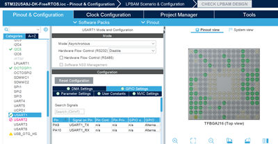

Hello @jessie_chiu ,
you are sharing the IOC file and it seems like you are not using the correct pins for UART communication . the UART instance connected to VCP (virtual com port)of STlink is UART1 on pins PA8 and PA9. check you configuration to make sure you are using the correct pins and if you are using printf to display the text make sure you are correctly surcharging it .

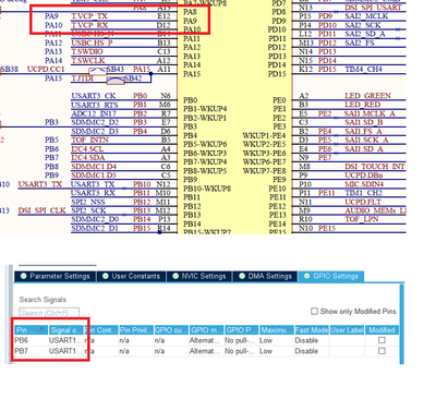

2024-03-18 8:53 AM
As stated by @STea you're not assigning the correct IOs for UART1 to connect it to VCP:
So replace PB6 by PA9 and PB7 by PA10 in CubeMx.
2024-03-18 6:02 PM
Thank you for your reply. I didn't notice the pin problem!!
But after I fixed the pin define, I still don't get the message.
Do you have any other suggestions?
