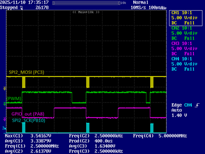

Hello DHIF Khaled,
The effect of __HAL_TIM_ENABLE_DMA(&htim15, TIM_DMA_UPDATE); was dramatic! I was able to execute the intended process. For synchronizing with TIM15, I used GPDMA1_REQUEST_TIM15_UP only for the first instance, and for the remaining nodes, I used DMA_REQUEST_SW, which allowed the DMA to execute all at once (though I'm not sure if this is the correct usage).
TIM15 executes at twice the frequency compared to other TIMs for PWM waveform generation, and it is used for 96-bit SPI input/output and for switching the PWM duty of other TIMs.

Hello DHIF Khaled,
