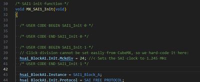

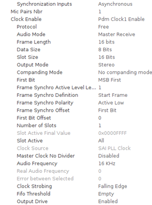

Figured I'd come back with the full solution. In the end I got a single PDM microphone to work with these settings:
Only the Mckdiv value I couldn't manage to change from CubeMX, so I added that as user code:

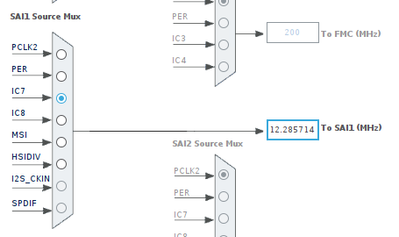

We want a SAI1_CK1 at around 1MHz for digital microphones.
The expected serial clock frequency is 2MHz (SAI1_CK1*2 because on this example we have only one microphone).
So, the master clock divider is set to 24 (Fsai_ker_clk/Fsck_a).
With this configuration, the recorded data after an external decimation of 64 will be at around 16kHz (1Mhz/16).

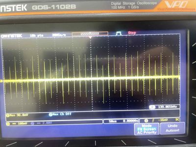

Hello, i am connecting mp34dt01-m one microphone to the NUCLEO-N657X0Q, and my SAI1_CK1 is unexpectedly like around 100KHz.
Here is my configurations below, can you help?
Also, added this after generating:
hsai_BlockA1.Init.Mckdiv = 12;
