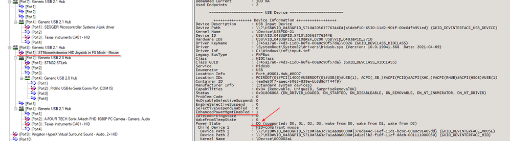

I have USB compocite device(USB HID+AudioInOut+CDC) on STM32L476 and I enabled LPM but my device do not receive Suspend(Device connected but no any data exchange)
I also tried example from:
STM32Cube_FW_L4_V1.17.0\Projects\32L476GDISCOVERY\Applications\USB_Device\HID_Standalone_LPMI disable any data sending to host but also do not receive suspend event.
I am testing it on Windows10, Windows has enable:USB selective suspend.
Also I try it on Android and also do not get correct suspend behavior.

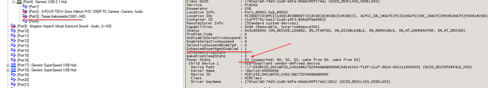

And one more point,my Windows10 has some device (I do not know who is it, it is part of my monitor) and seems this device in suspend mode and has no any BOS descriptor
But example has the followinf state:

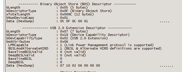

My BOS descriptor:
