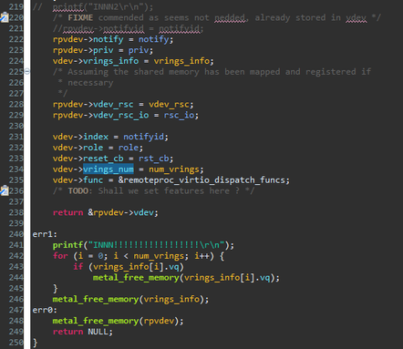

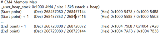

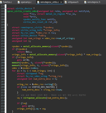

I checked that the error is a exception "err1" under the function "rproc_virtio_create_vdev" in the remoteproc_vrtio.c file. it was caused by the saturation of the memory "._user_heap_stack". Please refers to debugging results and the memory map.

# PICTURE1. The err1 under the function "rproc_virtio_create_vdev" in the remoteproc_virtio.c file

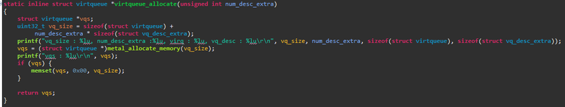

+) The function "virtqueue_allocate" codes
+) The function "metal_free_memory" codes
# PICTURE2. The debugging results
1) Hexadecimal conversion
2) Test end point
3) Test start point

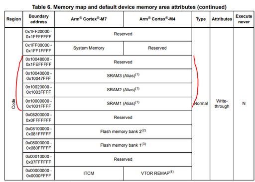

# PICTURE3. STM32H757 referece manual (RM0399)

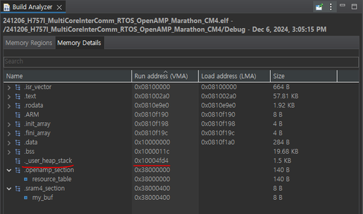

# PICTURE4. STM32CubeIDE build analyzer results
