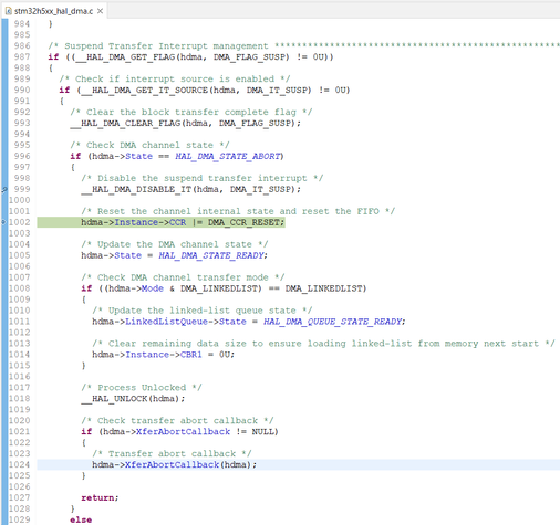

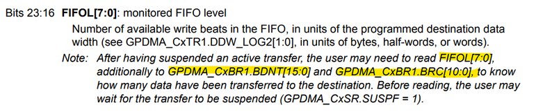

Thank you. The DMA channels have FIFO buffers (8 bytes in my case). And and the GPDMA_CxSR.FIFOL[7:0] bits contain the remaining write beats of the FIFO.
The problem I have now is that the HAL lib resets the fifo before calling the abort callback ...
I will try moving the call of the callback up to line 1000.
4 REPLIES 4

You may want to read the explanation to GPDMA_CxSR.FIFOL in the GPDMA chapter of RM0481.
