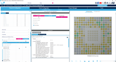

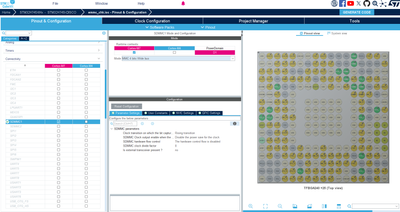

I am Manikandaprabhu, we are working with the STM32H745XIH6 MCU Disco Board and interfacing it with an eMMC module.The eMMC communication is working correctly on its own.
However, we are trying to integrate it with the FatFs filesystem for accessing based on file name,but it's not working.We are facing mounting error, when working with the FATFS file system. Can anyone provide the correct configuration steps and a sample code to initialize and use FatFs with eMMC on STM32H745?
Next we need to work with MMC 8 bit Wide Bus mode for fast communication but its only work with MMC 4 bit Wide Bus mode. How to work with 8 bit Wide Bus mode?
Which method based to select SDMMC clock divde factor ?
These are all my doubts. Kindly find and help me to resolve our queries regarding STM32H745XIH6 MCU Disco Board.
Thanking you.
