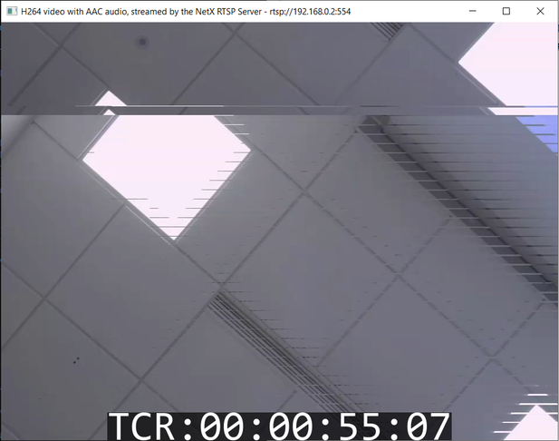

109: IMX335_SetFramerate(Camera_CompObj, 30);This gives the problem I have at 30 fps (no problem at 25 fps), the video cuts and distorts like this :

The bug you described seems to originate from an encoding that does not start at the beginning of a frame.
The VENC_RTSP_Server app is designed in a somewhat simplistic way. It uses "Slice mode," which has the advantage of lowering the memory footprint but the disadvantage of being somewhat subtle and sensitive to real-time constraints.
That being said, the artifact should disappear by applying the attached patch (it applies to V1.1.0). It involves ensuring that the encoding starts at the beginning of the frame.
