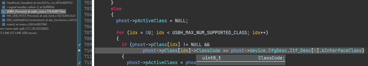

When I use Debugger, I can see a hard fault coming from USBH_Process :
case HOST_CHECK_CLASS:
if (phost->ClassNumber == 0U)
USBH_UsrLog("No Class has been registered.");
else
phost->pActiveClass = NULL;
for (idx = 0U; idx < USBH_MAX_NUM_SUPPORTED_CLASS; idx++)
if (phost->pClass[idx]->ClassCode == phost->device.CfgDesc.Itf_Desc[0].bInterfaceClass)
phost->pActiveClass = phost->pClass[idx];
break;
}The phost->pClass[idx]->ClassCode is unknown for SCSI USB 3.2 Keys.

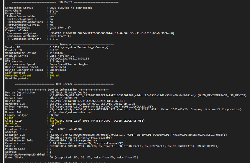

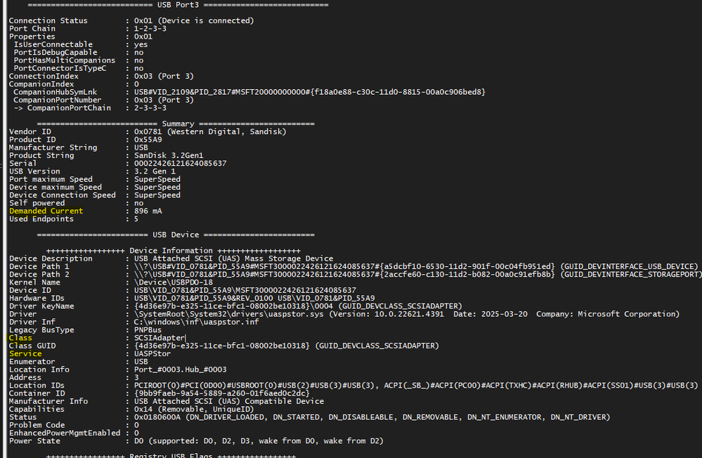

2025-04-30 8:12 AM
I use UsbTreeView to read device tree.
Here is what I find with the USB-C Key I cannot read in my bootloader.
This one is a USB-C Key I can read.
2025-04-30 8:30 AM
Ok so the problematic device has UASPstor protocol (its driver properly is uaspstor.sys). The ST library supports only MSC class. The interface protocol for legacy MSC is 0x50 (bulk-only), protocol for UASP is 0x62 and it has 4th interrupt endpoint. Also the UASP device requires almost 900 ma, check that your board can provide it.

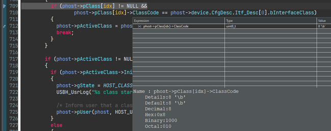

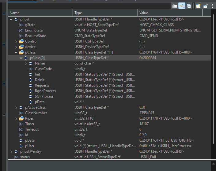

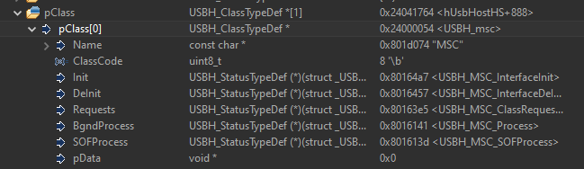

Here are screenshots of what I can see with the debugger.
* When I run the debugger with the MSC USB Flash Drive, USB_Host recognize the key properly:
* When I use the other USB-C Flash Drive with the scsi interface I have a hardfault because pClass[0] is undefined:
