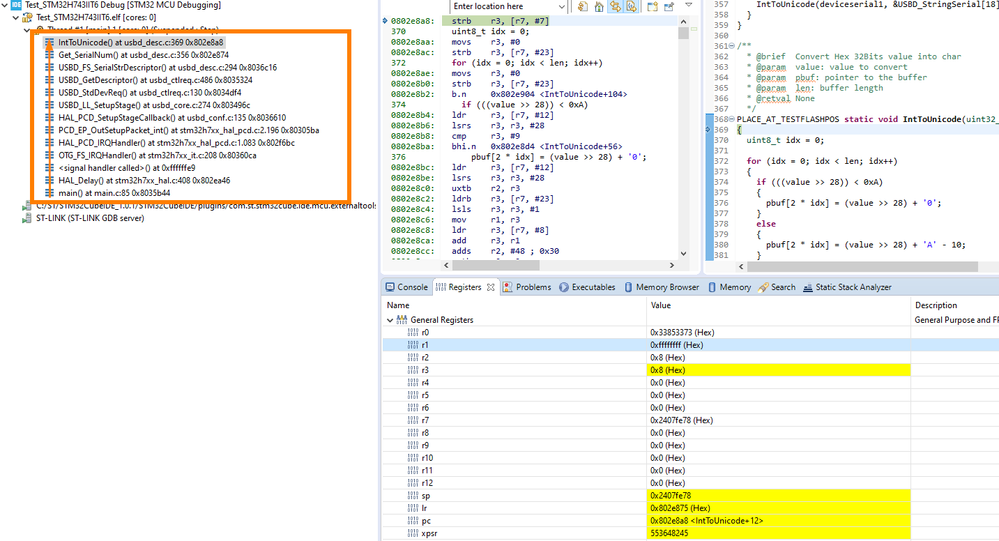

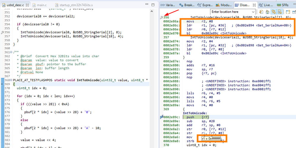

The failure occurs in the file usbd_desc.c, when the functon Get_SerialNum() calls a subroutine IntToUnicode() which shall convert an uint32 into its string representation.
I could track down that the calling function Get_SerialNum() provides a valid memory address at 0x24000164 where the string result shall be placed, but in case of that error the called function IntToUnicode() gets 0xFFFFFFFF as destination address which finally causes the hard fault. Screenshots are attached.

(1) Well, you guessed right, the chip has been mainly used for development during the last months. As first reaction I wanted to cry out that millions of write cycles can't be reached within that time, but the STM32H743 guarantees only 10k write cycles. Oops. So, on the one hand flash endurance may be at its limit, but on the other hand the flash seems to be ok because if e.g. a breakpoint is set in the calling function then register r1 is loaded with exactly the value that is expected in flash memory. So, it seems to be there, write access during programming is not an issue, but reading the value during execution time (which I cannot explain).
(2) Task context switching (including its stack space) was the next path I was following. My original project uses FreeRtos, but the error still exists in the test project which is without RTOS. Its stripped down to a simple main loop printing a "Hello World" message over USB VCP and a "." every HAL_Delay(1000). That's all. The lr register points to 0x802e875 in both modes (with and without the breakpoint in Get_SerialNum and, as result, with or without the hard fault issue). I was expecting 0x802e874 in lr because the call to the subroutine was made from 0x802e870 but maybe it's ARM-specific to set the lowest address bit in the return address...
(3) The screenshot provided shows the call stack which proves the same as the lr register. Basically the IntToUnicode function is called from Get_SerialNum as expected. I think it's worth to mention that all these functions are running in the USB IRQ handler context by the HAL and LL USB layers. As ARM doesn't support re-entrant IRQs it should not be possible to have another IRQ influence here. Or is this assumption wrong?
(4) Related to (1) I checked the flash peripheral registers, but no error has been detected there. The SR1 & SR2 registers as well as the ECC_FA1R & ECC_FA2R are all zero.
Screenshot: Call-Tree and registers shortly before the hard fault:

- Why does shifting the flash memory location for the functions in question by +/-4 bytes eliminate the hard fault error?
- Why and how can a breakpoint placed before the jump to the subroutine help so that register r1 is not changed to 0xFFFFFFFF?
- Is it maybe the 64-bit AXI bus interface not running properly when reading 32-bit literals from flash placed at 32-bit adresses?
