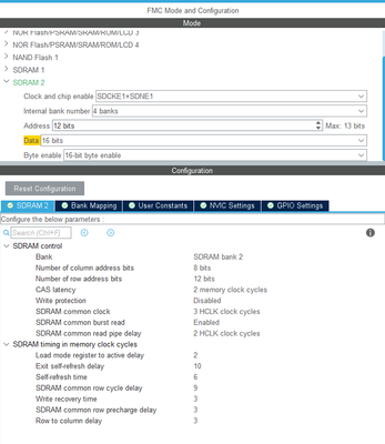

Hey, I am running into issues with a custom PCB based on STM32H743IIT6.

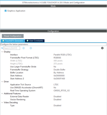

Using IS42S32400J-6TLI as SDRAM, with an LCD screen. Using TouchGFX and DMA2D deactivated.
A hard fault is encountered after entering Model:Tick()
Hard Fault Error Detected at:
Debug stack view:
LTDC:
SDRAM - only 16 data bits used:
TouchGFX:

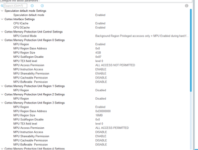

Seems to go to
Then BusFault Handler at :

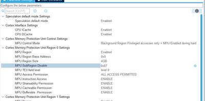

2026-02-11 7:59 AM
Applying new MCU settings:
I still get the BusFault_Handler error
